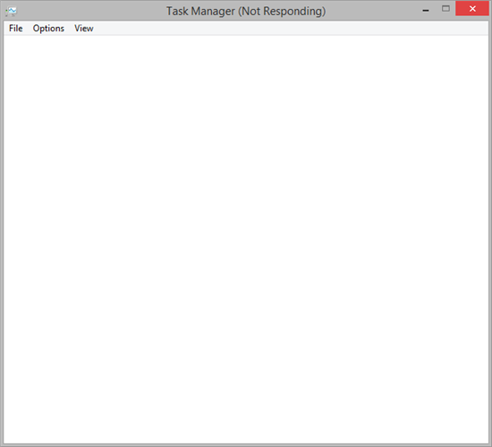

    I was able to connect the device to my Window 8.1 machine, and the problem with slow USB recognition was solved by setting static IP for the RNDIS using command line as mentioned above ( I was not able to bring up the windows' GUI adapter setting page, this RNDIS just freezes the task).
    The problem is even the device is successfully connected and I can use any kind of communication, it still freezes the task manager out, u just cant terminate the thing. More importantly, once the device has been connected to the PC, some applications such as: Visual studio, Microsoft Office, ... sometimes hang unexpectedly or could not startup. This is frustrating. I hope there are some workarounds for this.
    Here is what my task manager looks like when I try to terminate it:
