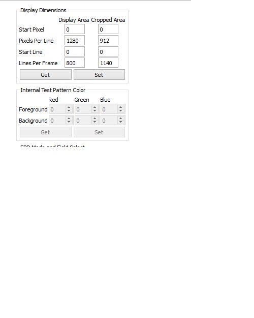

    I still have problem about third question. i already pick the Video Mode (like the picture)
    It seems like i can't set the "cropped area". After i set "start pixel" to 400, it will default back to 0.
    And actually i didn't understand what  these tabs mean. If i just want project the part of  912*1140  image (size like 200*200) ,how should i set?

  • Hello Zichao,
    Cropped Area - this is the actual source input resolution. For example - 912x1140, It remains constant.
    Display Area - this is what you can select portion of the DMD and display the image, i.e., selecting a valid value which is less than 1280x800 would result in displaying in the entire image within user set area.
    For example - if the source is 912x1140 and user set's Display Area = 640x480, then the input 912x1140 resolution image is scaled down to 640x480 and then displayed from (0,0) position - top right corner on the DMD.
    Couple of very important things -
    1. This is applicable only in VIDEO MODE.
    2. In the VIDEO MODE, if the Display Area is set to 1280x800 (WXGA resolution) then image is displayed full screen.
    3. This is functionality should not be used in application where 1:1 pixel mapping needed like Machine Vision Structured Light or 3D Printing etc...
