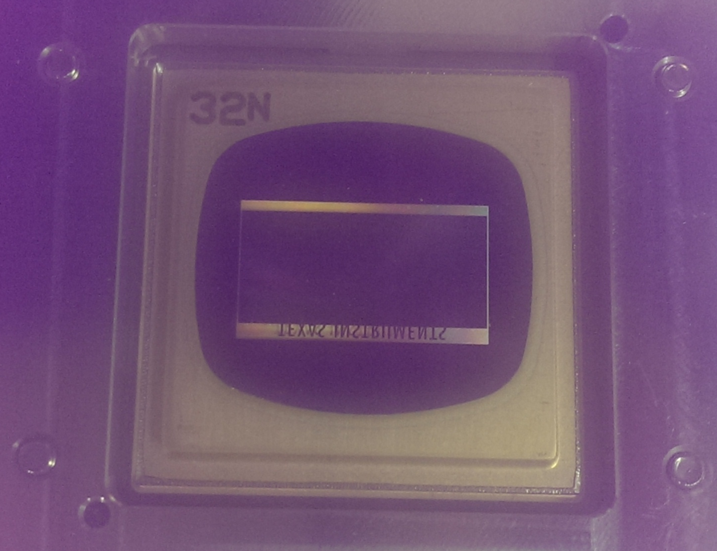

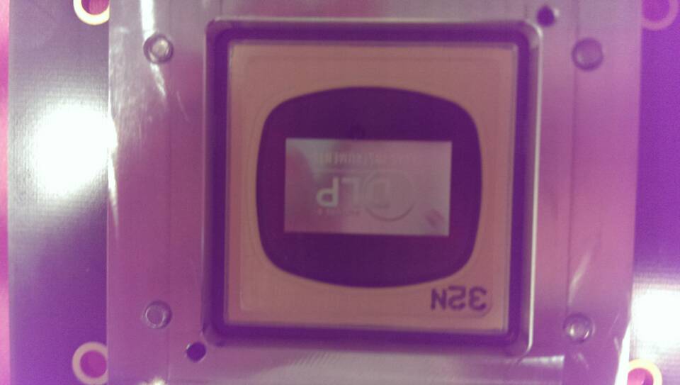

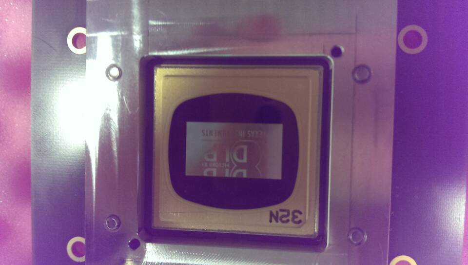

When i set NS_Flip, my image is flipped across the short axis. But, it isn't fliped completely. Indeed, there is just a part of my DMD shows the filiped image. The other part of DMD is still the no-fliped image.
Is there some one know the reason ?

    6. Here, the first image is the one i haven't set ns_flip, second and third when i set ns_flip.

    I am using DLP9500, so i think it's 1080p DMD device. I uesd my customized APPsFPGA, as i replied to Clinton. At first, i project one imgae by DMD. It works very well. Then, i set ns_flip. In my opinion, this image should be fliped. But, there is a problem like those images and, every time, i set  ns_flip, the image is different.
    Thanks a lot.

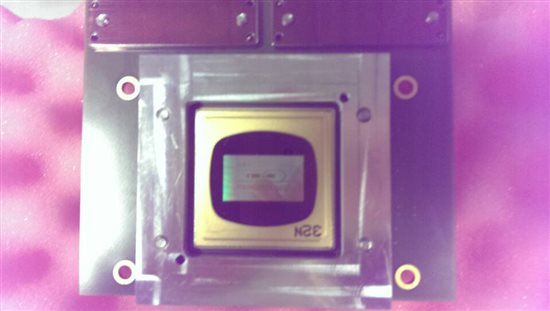

    I had modified my code. Now, my ns_flip is kept low during init_active=1, and when init_active=0, ns_flip is setted. And, this time, i tried to make this image move like a "video". I found when ns_flip was seted, the image was fliped, however, only the last lines of DMD works correctly. The most part of DMD is black, as you can see from my photo.

    Actually, as the picture posed in my last reply, when i set n/s_flip, i think dlp do flip the picture but only a part of dmd is reload/reset (at the bottom of DMD, the image appear correctly). The other part of DMD is always blocked.
