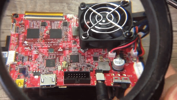

I connected power and USB cables and power on the board , LEDs light up and fan starts rotating , but after pressing ON/OFF switch(SW21)  it won't turn on the projector and board's status in  DLP LightCrafter Display is : " Contented , turned off "
Any clue where should I start diagnosing the problem?

    LEDs status are as follow:
    After  sliding PS_ON/OFF switch(SW28)to the ON position:
    D75 : lights up and stays ON
    +3.3V LED:  lights up and stays ON
    D66 , D67 : flash like 100msec
    After Pushing ON/OFF switch (SW21) :
    D56  : Blinks ON and OFF and stays OFF
    D57  : Blink OFF and ON and stays ON
    D33  :OFF(no change)
    D34  :OFF(no change)
    D36  :OFF(no change)

    This is a gif I made from powering ON the board and pressing SW21 after that.
    I hope I cover all LEDs status
    If is there any thing I can do to narrow done to problem cause , please let me know.
