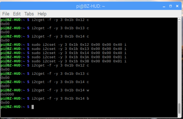

Hi
trying to set get the temperature and LED current on the EVM connected to a raspberry pi following the thread https://e2e.ti.com/support/dlp__mems_micro-electro-mechanical_systems/video_and_data_display/f/947/p/635358/2344174?tisearch=e2e-sitesearch&keymatch=dlpc2607%20lumens#2344174
However, unable to change the LED current to 100% duty cycle when i tried the below.
i think i'm using the correct address and function, so help please? the raspberry pi doesn't allow the use of 0x400
also, how would I set the LED current to 25% or 50% duty cycle? would it be 0x10 and 0x20?
  • Philbert,
    Can you explain what you mean by 100% duty cycle current? The brightness of the LEDs do not actually correspond to the duty cycle. It is possible we are both thinking of two different problems.
    Philippe Dollo
  • Hi Philippe
    I'm referring to the DLPC2607 software programmers guide section 2.4.1.11.2, 2.4.1.11.3, 2.4.1.11.4.
    previously mention in the post above you said 'In order to change the system brightness, you need to do two things. First, you need to adjust the LED current register settings'
    to clarify, I am trying to change the brightness of the projected image.
  • Philbert,
    The python sample scripts provided with the DLPDLCR2000EVM have example code to show how to adjust system brightness. You can get a link to the repo with these scripts here:
    github.com/.../DLPDLCR2000
    I hope this helps.
    Philippe Dollo
