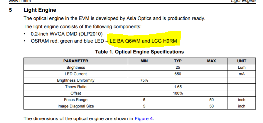

What LEDs are used in the DLP2010EVM (Lightcrafter 2010)? Would like to know their datasheets and specs.
Need to have them disconnected from the EVM PCB and driven manually so would like to know their recommended V/A rating for continuous operation (not modulating).
