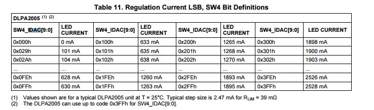

I would like to set the default current for the LEDs. I know that we can set this by changing the firmware of the device. The problem is that I was playing before with the advanced GUI tool and when I tried to set the current of the LEDs with a batch file, I didn't gave me the current I wanted.
I noticed that by getting the current value from the advanced tool or the normal tool, we don't get the same result (e.g 405 in advanced mode and 1001 in normal). And the current set with the batch file is actually correct if you check the value in advanced mode.
So I would like to know to what each value correspond, or if its just a bug from the GUI and which value would be correct. Thank you !
