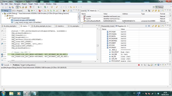

  • Hello Jon M,
    I have tried to put the C5535 in RTC only mode using then code attached below (last two lines of code). Unfortunately this makes the algorithm stop working and even if I use an RTC interrupt I can not manage my algorithm to keep on running. I would appreciate if you could give me any clue to what I am doing wrong.
    Ramon

    rtcConfig.rtcyear = 0;
    rtcConfig.rtcmonth = 0;
    rtcConfig.rtcday = 0;
    rtcConfig.rtchour = 0;
    rtcConfig.rtcmin = 0;
    rtcConfig.rtcsec = 0;
    rtcConfig.rtcmSec = 0;
    rtcConfig.rtcyeara = 0;
    rtcConfig.rtcmontha = 0;
    rtcConfig.rtcdaya = 0;
    rtcConfig.rtchoura = 0;
    rtcConfig.rtcmina = 0;
    rtcConfig.rtcseca = 0;
    rtcConfig.rtcmSeca = 0;
    rtcConfig.rtcintcr = 0x0002;
    /* Set the RTC init structure */
    InitDate.year = 0;
    InitDate.month = 0;
    InitDate.day = 0;
    InitTime.hours = 0;
    InitTime.mins = 0;
    InitTime.secs = 0;
    InitTime.mSecs = 0;
    /* Register the ISR function */
    isrAddr.SecEvtAddr = rtc_secIntc;
    status1 = RTC_setCallback(&rtcDispatchTable, &isrAddr);
    IRQ_globalDisable();
    IRQ_clearAll();
    IRQ_disableAll();
    IRQ_setVecs((Uint32)&VECSTART);
    IRQ_clear(RTC_EVENT);
    IRQ_plug (RTC_EVENT, &rtc_isr);
    IRQ_enable(RTC_EVENT);
    IRQ_globalEnable();
    /* Reset the RTC */
    RTC_reset();
    CSL_FINST(CSL_RTC_REGS->RTCPMGT, RTC_RTCPMGT_BG_PD,SET);
    CSL_FINST(CSL_RTC_REGS->RTCPMGT, RTC_RTCPMGT_LDO_PD,SET);
