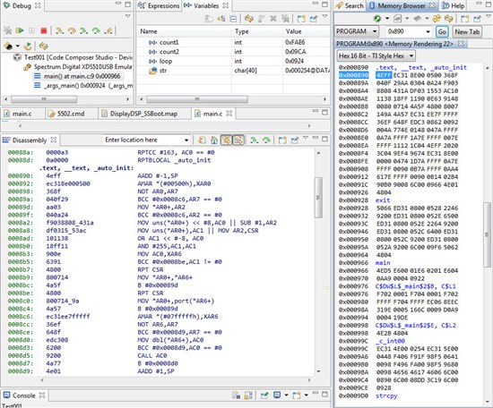

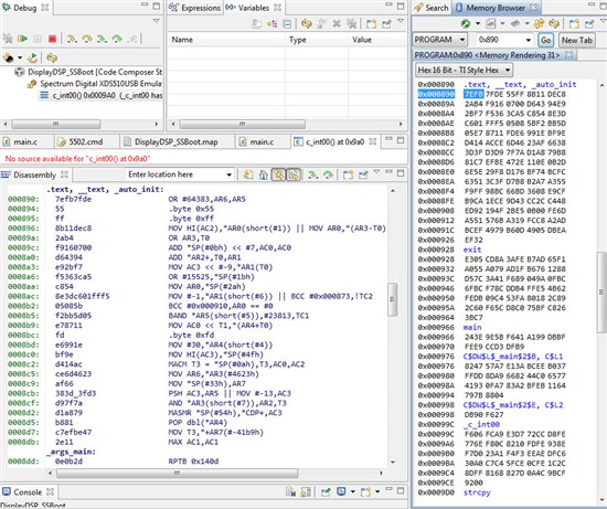

         Thanks for all the help to date.  I think I am close, but still cannot get the program working.  I seem to be writing the data from flash to internal RAM incorrectly.  I have simplified the example program you sent me and it is included in the this post along with some screen captures from my debugging sessions. In essence, I copy a byte from the serial flash and shift it into a 16 word, then copy the next byte and add it to the 16 bit word, then write the word to internal RAM. When I single step through the code, the date is being written to the correct address in internal RAM, so I am thinking that I am not packing the data correctly.
         The first screen capture is when the test application has been loaded by the CCS debugger. The test application runs okay when loaded by the debugger.
    The next screen capture is the test application loaded by my second stage boot application.  As you can see, the program memory is different from the first image, where the test application is loaded by the debugger.

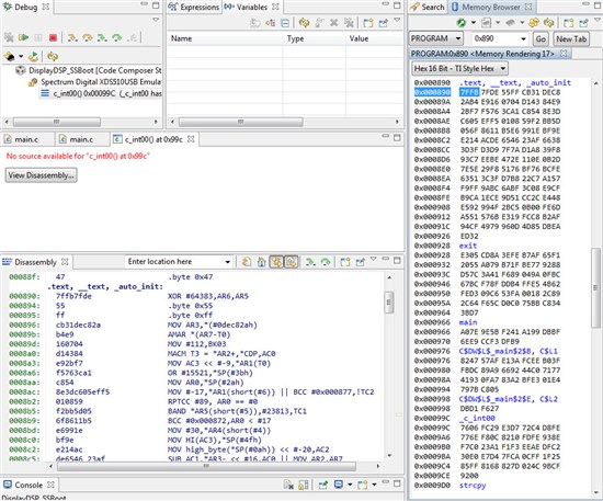

  • Hi Bill,
          Some additional screen captures. The screen capture below was taken right after the Test program was loaded by the second stage loader.  It is a view of "Data" memory and matches with the data in the .bin file.  So, I think that according to "Data" view of memory, I copied then data from the .bin file correctly and to the correct location in memory. However, if you look at the disassembly window, the instructions are not correct.
    Below is the same session, viewing the "program" memory.  It does not match the "data" memory view.
         When I load the same test program with the debugger, the "program" memory view and the "data" memory view match:
    Stephen

  • Stephen,
    I think I got it; another difference between the bootloaders.  The destination addresses in the .bin file are byte addresses.  The DSP uses word addresses for data.  So just change line 96 in your program from:
    pDest = (uint16_t*) destAddr;
    to
    pDest = (uint16_t*) (destAddr >> 1);
    and you'll be all set.  (I'd add a comment too.)
    Bill
  • Hi Bill,
         Thanks.  Your suggestion was right on.  As soon as I made your suggested change, everything started to work. Thanks for hanging in there with this problem.  Your help is really appreciated.
    Question Answered and Problem Solved!!!
