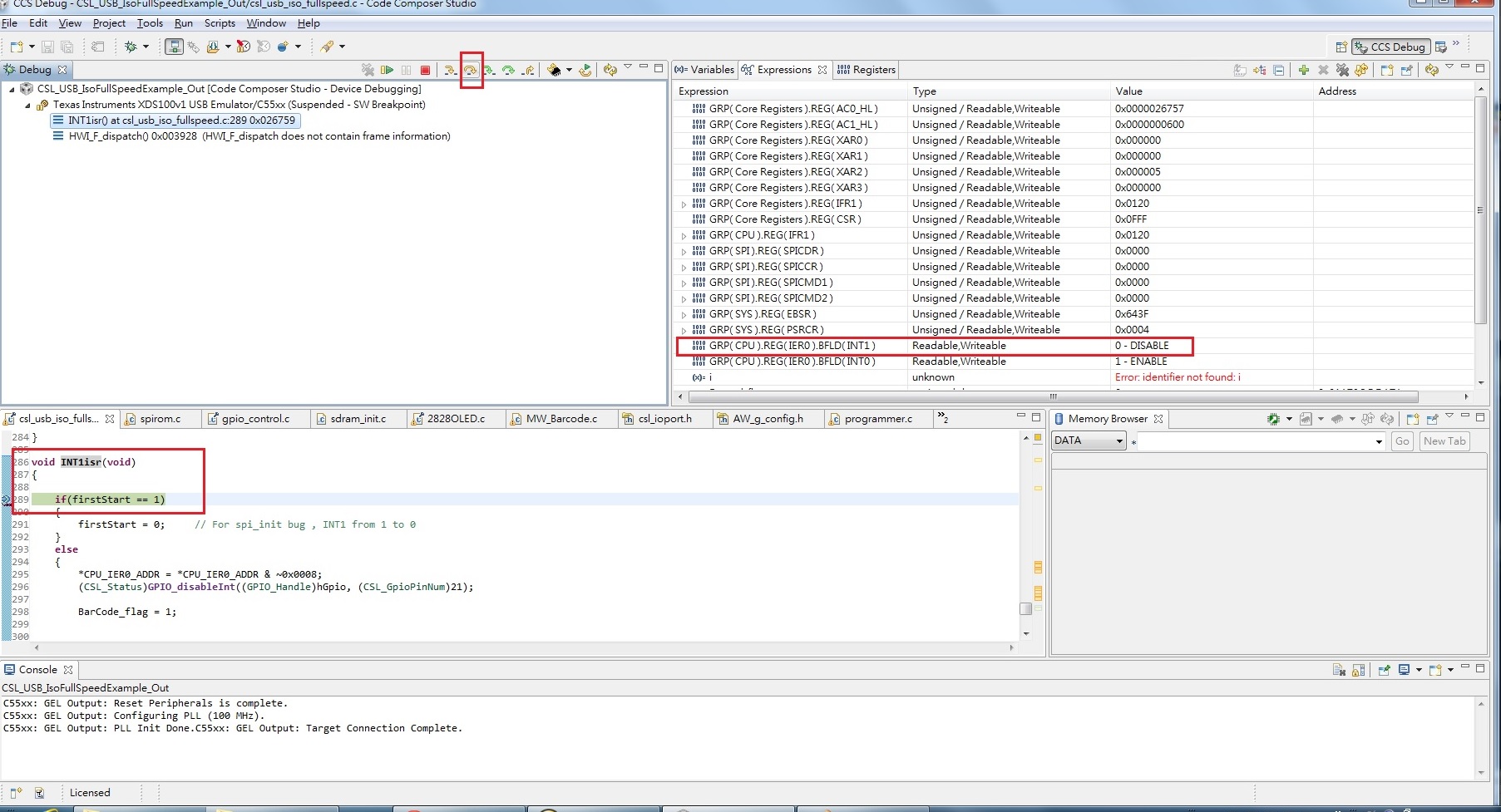

      I need to use spirom_init(); and spi write (NAND flash) to save our code.
    I don't know why SPI init function will affect INT1 flag.
    If I don't use SPI init function , the INT1 flag is normally.
  • The attached is INT1 status.
    INT1 flag  is affected. The code flow from line 236 to line 289.
    If disable SPI init function , the code flow from line 236 to My task. The code flow is correctly.

    Which CSL code do you recommend for SPI init function?  (SPI flash)
    For interrupt line , I just set INT0=1 and INT1 = 1.
    I used "Step Over" from *CPU_IER0_ADDR = *CPU_IER0_ADDR | 0x000C; line to LongWait0(5) , the INT1 is changed from 1 to 0 , the code flow is running to INT1.
    (The above 002.jpg)
    I am using Custom board.
    For this issue , I didn't have any idea yet .
