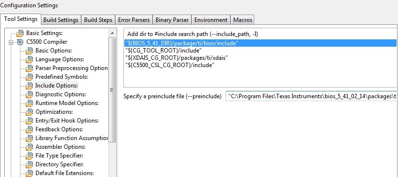

I want to compile ECG_NonBIOS.pjt programme on ccs v4 with using evm5515 and ads1x98ecg fe boards, but i couldn't. Firstly i connected to target succesfully and after i debugged the programme but I have taken the below massages on the console.
**** Build of configuration Debug for project ECG_NonBIOS ****
C:\Program Files\Texas Instruments\ccsv4\utils\gmake\gmake -k all
'Building file: ../src/ADS1298Init.c'
'Invoking: Compiler'
"C:/Program Files/Texas Instruments/ccsv4/tools/compiler/c5500/bin/cl55" -v5515 -g --define="_DEBUG" --define="C55X" --include_path="/package/ti/bios/include" --include_path="C:/Program Files/Texas Instruments/ccsv4/tools/compiler/c5500/include" --include_path="/packages/ti/xdais" --include_path="/include" --preinclude="C:/Program Files/Texas Instruments/bios_5_41_02_14/packages/ti/bios/include/tistdtypes.h" --diag_warning=225 --large_memory_model --ptrdiff_size=32 --algebraic --memory_model=huge --preproc_with_compile --preproc_dependency="src/ADS1298Init.pp" "../src/ADS1298Init.c"
>> WARNING: version specified in option -v5515 is unknown (ignored)
>> ERROR: Huge memory model not supported for CPU revisions 1 or 2
C:\Program Files\Texas Instruments\ccsv4\utils\gmake\gmake: *** [ADS1298Init.obj] Error 1

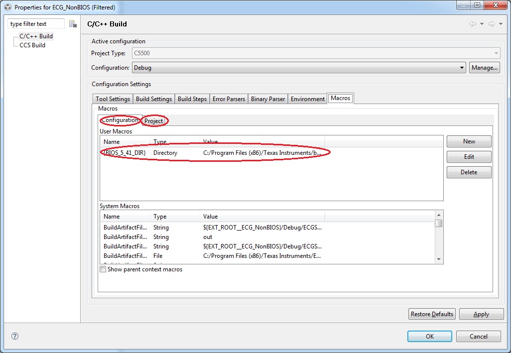

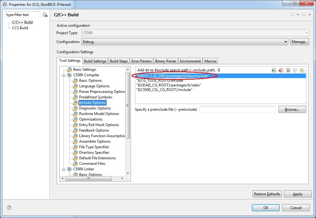

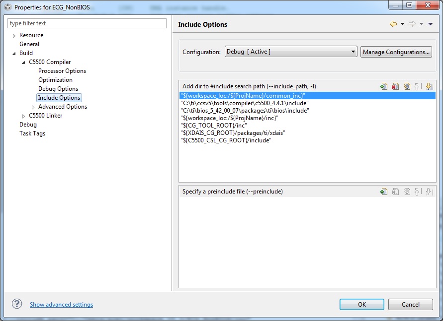

I have readed the build properties and include options issue, so i have changed the include settings.

  • Change the memory model selection to "large" in Properties->Runtime Model Options.
    Regards.
  • Depending on the version of the C55x compiler (not the same as the CCS version), the -v5515 option may not be supported. It appears you have such a version of the compiler. Instead of -v5515, try -vcpu:3.3. If that doesn't work, tell us the version of the compiler. You can determine this by running "cl55 -version" from the command line.

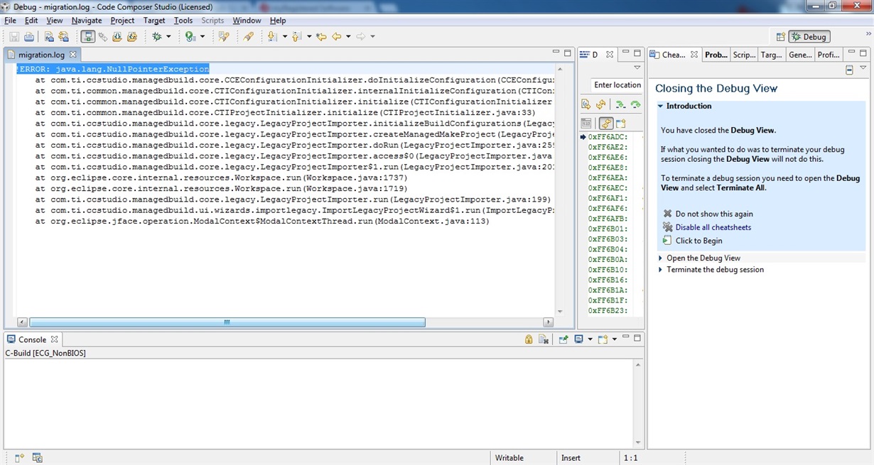

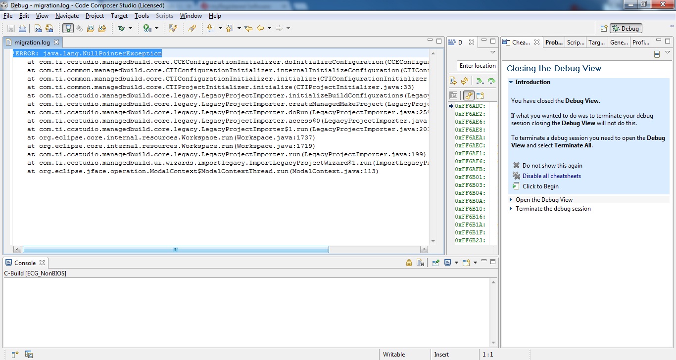

  • Ok i found the code generation tool version 3.3 from "software_dl.ti.com" web site and i selected it while importing project. But an error displays at the below picture it says "nothing to build for the project".
    And migration log,
    I couldn't understand what the problem is,
    Regards.
  • You do not want to downgrade the compiler version to 3.3.0; it is quite old. If possible, you should upgrade to 4.4.2 instead. However, 4.3.5 should work just fine. In the project options, you should find an option box which currently says C5515; you want to change that to "cpu:3.3" without the quotation marks.
  • Hi Archaeologist,

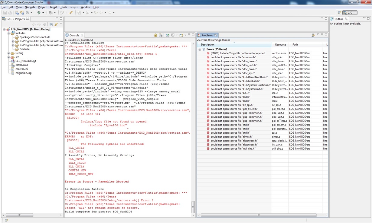

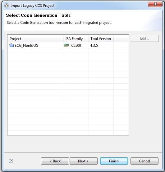

    I import file legacy because of the old version and migrate the project. (My compile version 4.3.5). I set some options.
    But 25 errors display,
    I'm glad for your helps,
    Regards.
  • When you imported the project, you lost the definition of variable C5500_CSL_CG_ROOT. Make sure this variable is defined correctly and try again, please.

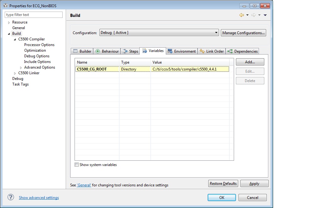

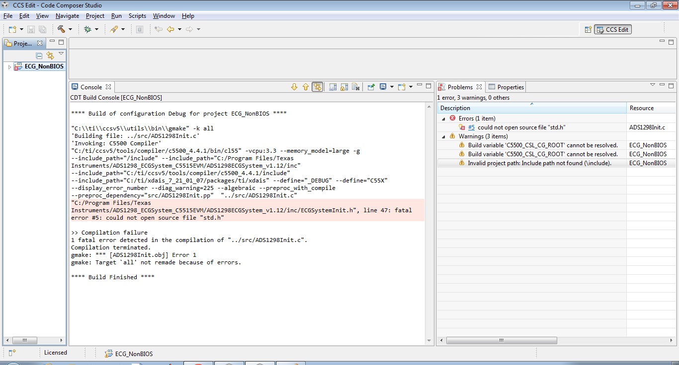

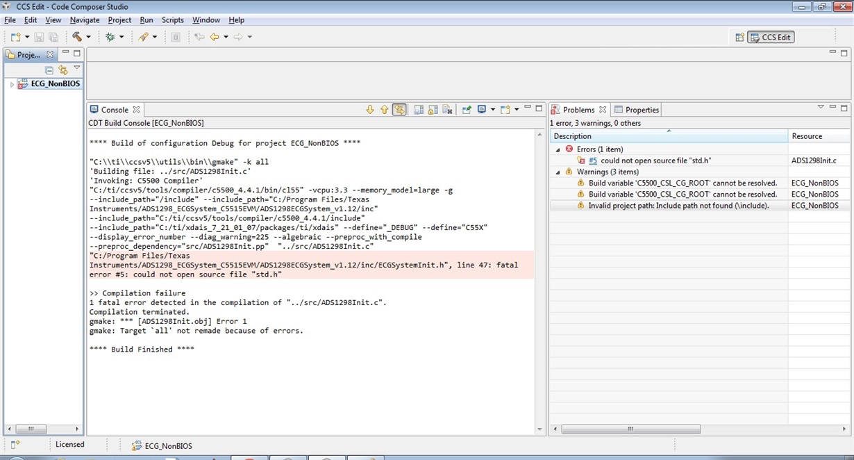

    Thank you for your reply. Your reply helps me and i finally get 1 error :) (This time i used ccsv5.3 and compiler version 4.4.1)
    But i still got some problems such as;

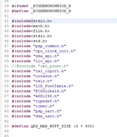

    it only says "could not open std.h file.
    Regards.
  • I think you still need to check the definition of C5500_CSL_CG_ROOT. Your screenshot shows that C5500_CG_ROOT is defined, but that's a different variable. In your last screenshot, notice the warnings about C5500_CSL_CG_ROOT. Also notice that one of the command-line arguments to the compiler is --include_path="/include", which is unlikely to be correct, and probably comes from the line ${C5500_CSL_CG_ROOT}/include in your include search path.
  • Thank you for your reply.
    I understood that it is all about the project location. My project is located on workspace,  actually i select "copy projects into workspace" selection.

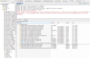

    Finally i compile it, but there were lots of warnings.
    Am i still wrong on somewhere? How can i fix it?
    Regards.
  • Those are all minor warnings; if your program runs correctly, you don't have to deal with them. However, you might still want to clean them up. You could start with C5500_CSL_CG_ROOT, which is still unset. Unfortunately, I don't know what its value should be, nor how to set it in CCSv4. It should have been set up automatically when CSL was installed. You might want to start a new project and copy your source files to the new project.

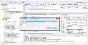

    I compilled and after i loaded the program of ECG_.NonBIOS.out.
    But i couldn't get the right signal.
    It says "Can't find a source file at "C:\WorkTI\SW\MDK\ECG_ADS1298\PG2\C5515EVM".
    Regards.
  • I'm sorry, I believe you are now beyond my knowledge. You'll probably need to start a new thread to get the attention of someone who knows more about how to use EVMs. As for the "Can't find a source file" error, I suspect that is just because CCS can't find the source file to display the code corresponding to the PC the EVM is halted at; it is a non-fatal error.
