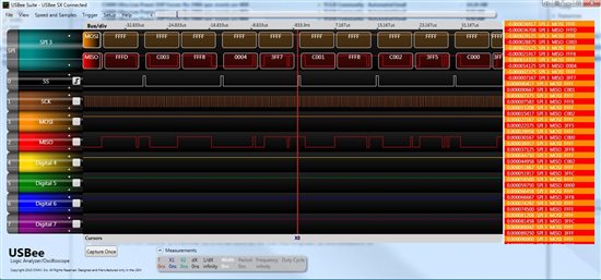

I'm still struggling to get a McBSP DMA chain going with my C5510.  The McBSP is working great when I manually read it with MCBSP_read32( hMcbsp );  When I try to trigger DMA transactions off of the RSYNC events from this McBSP port, everything goes awry.  :(  Here's the situation...
  • McBSP0 hooked up to a serial ADC.
  • FSR is the conversion clock for the ADC.
  • The DR and CLKR pins are also hooked up to the ADC, and again, I can read the ADC just fine using MCBSP_read32()
  • The McBSP is generating FSR, and CLKR using the Sample Rate Generator, and they're outputs.
  • I've set up DMA transactions to source from the McBSP like so...

The DMAs never happen, and at first I thought it was because I had setup the ISR incorrectly, or hadn't appropriately enabled the IRQ or something.  But then I started polling the SYNC bit of DMACSR, and it never goes high.
But here's where the plot thickens.  If I do a manual read (MCBSP_read32), I get a SYNC event in my DMA engine.  And I can do manual reads like that and watch the DMA counts increment as well.  WHAT GIVES???
I've been wondering if maybe the fact that I'm sourcing the FSR and CLKR has anything to do with it.  I have the McBSP in free running mode, so those lines are always going.  (Verified with an LA.)  Or I was wondering if DRR1 is still the appropriate address for the DMA since it's a 32-bit read, and DRR2 must be read first for data integrity issues.  I don't know.  I'm grasping at straws here.  Anyone have any in-depth insight into the McBSP/DMA interactions in the C55xx series?  Any help would be much appreciated.  Thanks.
p.s. I do call DMA_start... see below

  • I was trying to generate SYNC events from the McBSP to the DMA engine on RRDY.  I assumed that happened when I set the McBSP SPCR1 RRDY interrupts generation, and then set the DMA to SRC off of my McBSP DRR1.  Is there an additional step I'm not aware of?  If so, I'd love to know where that's documented.
    Also, I still wonder about whether I should give DRR1 or DRR2 as the source address to my DMA engine, given that it's a 32-bit read, and all of the McBSP documentation says to read DRR2 first in 32-bit applications.  I couldn't tell if that's true for DMA read access as well.
    I'll try to get a register dump of my DMA regs and post them in a follow up.

  • EXACTLY!!!  :)  I agree 100%!  Since my chip is the master, and it's ALWAYS pumping out the bit clock and frame clock, there should always be data in DRR and RRDY should always be high, in my estimation.  I have a little USBee logic analyzer pod, and as soon as I MCBSP_start(), I see Frame Sync and the Bit Clock buzzing away and the ADC is putting out valid data on the DR0 line.  But even if the ADC were putting out garbo, I'd think it would still assert RRDY.
    That scope shot is taken literally while I'm waiting for DMA's and SYNC and my isr to be called, with no joy.
