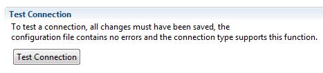

    When you double click on the Target configuration, it should open up a "test connection" button. Does that pass?

    I just downloaded and used CCS V6 just to test the connection (V4 doesn't have that feature I guess, but I am using V4 mainly.) This is the message I receive:
    [Start: Texas Instruments XDS100v2 USB Emulator_0]
    Execute the command:
    %ccs_base%/common/uscif/dbgjtag -f %boarddatafile% -rv -o -F inform,logfile=yes -S pathlength -S integrity
    [Result]
    -----[Print the board config pathname(s)]------------------------------------
    C:\Users\Ashlee\AppData\Local\TEXASI~1\CCS\
    ti\0\0\BrdDat\testBoard.dat
    -----[Print the reset-command software log-file]-----------------------------
    This utility has selected a 100- or 510-class product.
    This utility will load the adapter 'jioserdesusb.dll'.
    The library build date was 'Sep 4 2015'.
    The library build time was '21:59:23'.
    The library package version is '6.0.14.5'.
    The library component version is '35.35.0.0'.
    The controller does not use a programmable FPGA.
    The controller has a version number of '4' (0x00000004).
    The controller has an insertion length of '0' (0x00000000).
    This utility will attempt to reset the controller.
    This utility has successfully reset the controller.
    -----[Print the reset-command hardware log-file]-----------------------------
    The scan-path will be reset by toggling the JTAG TRST signal.
    The controller is the FTDI FT2232 with USB interface.
    The link from controller to target is direct (without cable).
    The software is configured for FTDI FT2232 features.
    The controller cannot monitor the value on the EMU[0] pin.
    The controller cannot monitor the value on the EMU[1] pin.
    The controller cannot control the timing on output pins.
    The controller cannot control the timing on input pins.
    The scan-path link-delay has been set to exactly '0' (0x0000).
    An error occurred while hard opening the controller.
    -----[An error has occurred and this utility has aborted]--------------------
    This error is generated by TI's USCIF driver or utilities.
    The value is '-150' (0xffffff6a).
    The title is 'SC_ERR_FTDI_FAIL'.
    The explanation is:
    One of the FTDI driver functions used during
    configuration returned a invalid status or an error.
    [End: Texas Instruments XDS100v2 USB Emulator_0]
