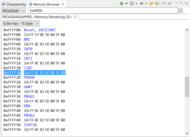

Hello, I need some help resolving a problem with the timer interrupt service vector.  At this time, I would like to learn as much as possible about the TMS320C55xx family so I am intentionally excluding any CSL or DSP/BIOS methods.  So far I have taken the time to read many vector/interrupt posts on this forum and all of the support literature (SPRUH87F, SPRU280I, SWPU073e, etc.).  The problem I am encountering is all but the reset vector, _c_int00 at address 0xFFFF00 (ROM) is being written incorrectly (or never written).  But before I continue, let me give some information about my setup:
IDE: Code Composer Studio V6.1.2.00015
DSP processor: TMS320C5535
Dev Hardware Platform: TMS320C5535 eZdsp USB kit
This is what I have done so far:
  1. Copied a ‘vector.asm’ example file (mnemonic type) and modified it to include a .ref _timerISR symbol so the compiler knows the _timerISR symbol is defined in another file (‘main.c’).  Added the ‘vector.asm’ file to the project.
  2. In ‘main.c’, configured Timer0 to interrupt once every 100,000 cycles of the system clock.
  3. In ‘main.c’ created a subroutine called ‘interrupt void timerISR()’ using the keyword interrupt, also included a prototype declaration for this subroutine.
  4. Complied the project.  No errors reported.
  5. Loaded the assembled code into dev platform to be debugged.  Proceeded to the ‘Memory Browser’ to validate the interrupt vector table located at ROM (PROGRAM) address 0xFFFF00.  This is where I notice only the Reset has a valid 8-byte entry?

From the ROM Memory Browser, the TINT vector is the same as all of the other unused interrupts, so clearly there is something wrong.  Not sure where to go from here, so any comments are greatly welcomed.
Thanks for everyone’s time.
