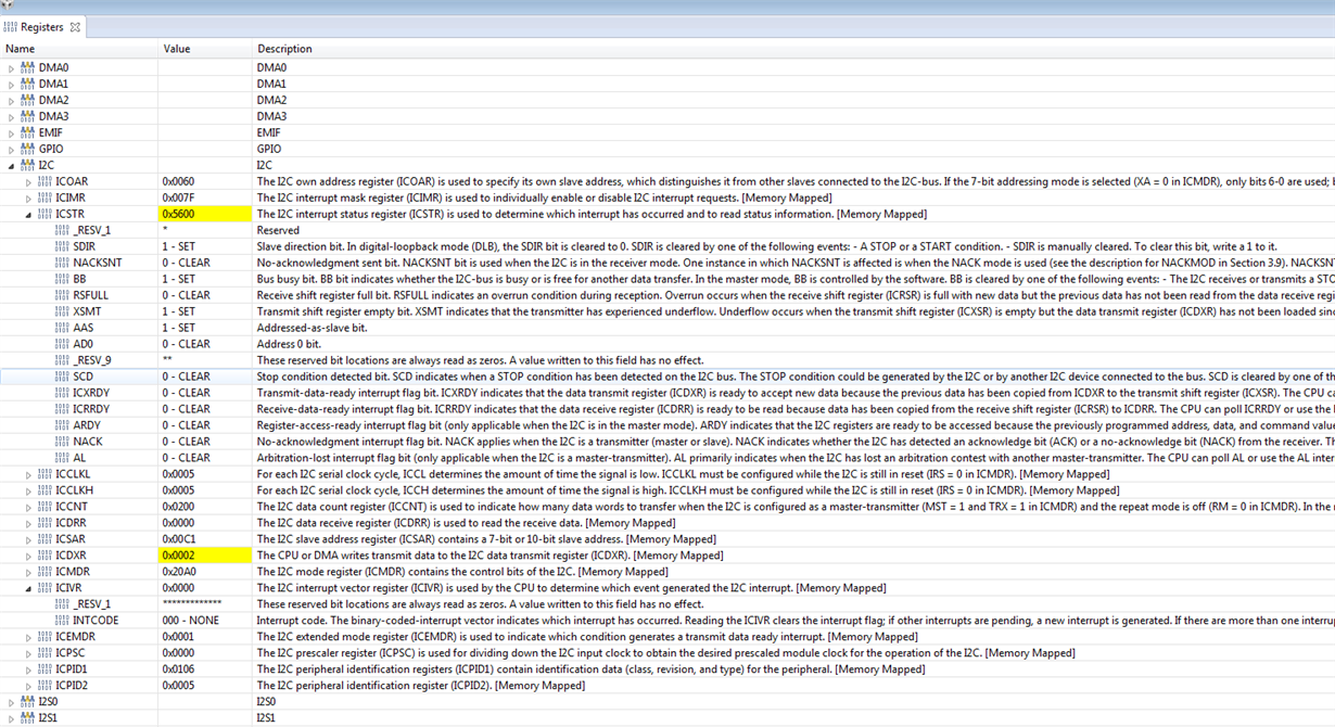

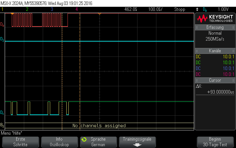

I trying to use the i2c to read with my i.mx6 board from the DSP.
my i.mx6 board is the master -> eZdsp should be slave !
i only can read one byte from the DSP ! when i try to read more than one byte its not working !
i use the read() function on the i.mx6 board.
this works with one bye! ->
        int numberBytes = EZDSP_BUFFER;
           int bytesRead = read(file, this->dataBuffer, 1);
           std::cout << "bytes Read = "<< bytesRead << std::endl;
           std::cout << "bytes Read = "<< this->dataBuffer[0] << std::endl;
           if (bytesRead == -1){
               std::cout << "Failure to read" << std::endl;

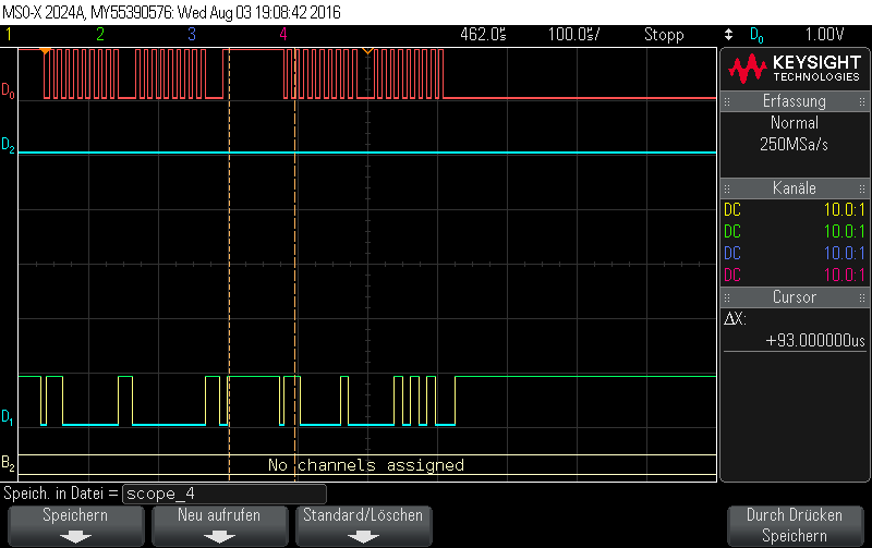

But when it try to read morge then one byte like this:
           int bytesRead = read(file, this->dataBuffer, 512);
its not working !
please help me... here is my eZdps code :

	CSL_FINST(i2cHandle->i2cRegs->ICEMDR, I2C_ICMDR_MST, CLEAR);
	CSL_FINST(i2cHandle->i2cRegs->ICMDR, I2C_ICMDR_STB, CLEAR);
	CSL_FINST(i2cHandle->i2cRegs->ICMDR, I2C_ICMDR_RM, SET); // RM,STP, STT -> Repeat mode transfer: START condition, slave address, continuous data transfers	until STOP condition or next START condition
	CSL_FINST(CSL_I2C_0_REGS->ICMDR, I2C_ICMDR_STP, CLEAR);
	CSL_FINST(CSL_I2C_0_REGS->ICMDR, I2C_ICMDR_STT, SET);
	//CSL_I2C0_WRITEREG(ICMDR,CSL_I2C_ICMDR_MST_CLEAR);
	//CSL_I2C0_WRITEREG(ICEMDR,CSL_I2C_ICEMDR_BCM_SET);
	//CSL_I2C0_WRITEREG(ICMDR,CSL_I2C_ICMDR_STT_SET);
	//CSL_FINST(i2cHandle->i2cRegs->ICEMDR, I2C_ICEMDR_BCM, SET);
	i2cErrInTx = FALSE;
	i2cTxCount = 0;
	dataLength = CSL_I2C_DATA_SIZE;
	return 0;
