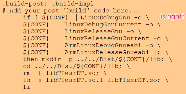

  • Hi Lali,
    I followed the steps in the ReadMeFirst.txt,but encountered the same problem.First,i built the TIesrDT API by the following order: make LinuxDebugGnu PROJECTS='TIesrDTso',everything was ok.Then i built the TestTIesrDT by the same order,but this time a error occured(attached are the details).
    Why this problem occured?Because i did not fix the makefile from TIesrDTso ?
    About fixing the makefile,i am puzzled.How to fix it?Just erase one = from the if part of the makefile as i did as followed:
    My understanding is right?
    Another question is how to add -lpthread to \TIesr_model_build\TIesrSI\TestTIesrSI\nbproject\Makefile-LinuxDebugGnu.mk?
    Forgive me ,I am a newbie in Linux.
    Eric
