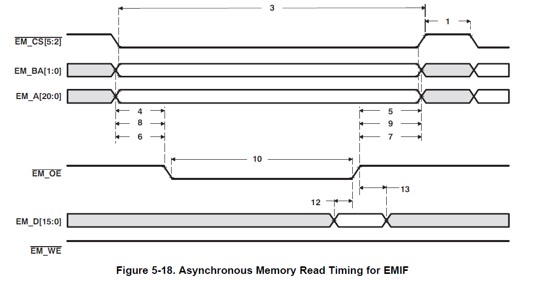

    My recommendation is to align your timing as per “ Timing Requirements for EMIF Asynchronous Memory ” mentioned in C5515 datasheet “SPRS645F “ table 5-18 ,Table 5-19. Refer to the Asynchronous read timing diagram 5-18 in the same document.
    Based on this information, you can configure ACSnCR2 register to achieve minimum sampling time possible. The one which you are referring in user guide is an example and I do not think it specifies the minimum timing requirement.

  • From the timing diagram you show, the minimum read cycle time is parameters (1) + (3).  From the definitions of these parameters in Table 5-19, minimum read time is (TA) + (RS + RST + RH)
    Where:
    TA = R_TURNAROUND
    RS = R_SETUP
    RST = R_STROBE
    RH = R_HOLD
    I believe the minimum for RS, RST, and RH is 1.  I think for successive reads, the minimum is 0.  In theory then, the minimum is 3 clock cycles.  In practice, the minimum I can achieve is 5 clocks.
    Maybe that is my problem.  Is the turn around time 0 for successive reads?

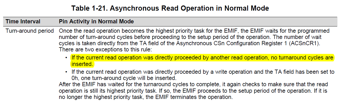

  • If its successive read, then no Turnaround cycles are required.
    Below is the snapshot from User guide for your reference.
    Hope this helps.
     Vasanth
