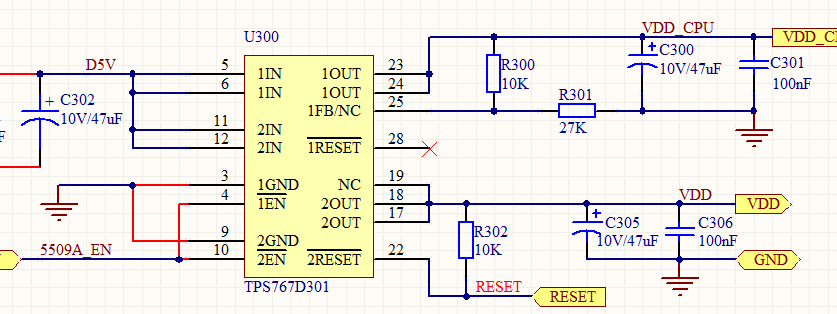

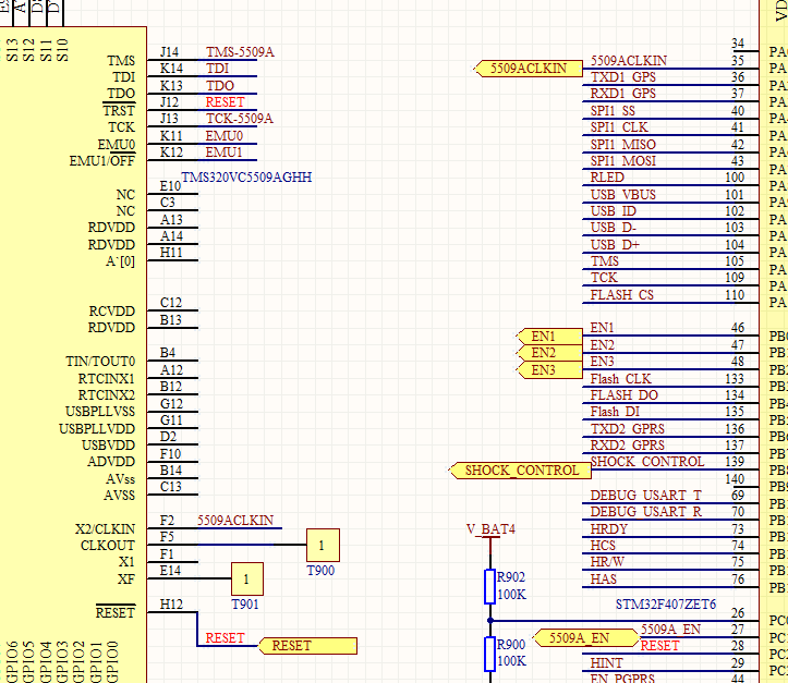

There are threes parts in my design .Power(TPS767D301)  MCU(STM32F103) DSP(TMS320VC5509AGHH).
1.Does it ok that DSP Pin TRST and Pin Reset connect together?
2.Does it  ok that DSP Pin(TRST RESET) connect with Power Reset Pin.?
    I see your RESET signal is driven by the MCU.
    I will ask if it is okay to tie both TRST and Reset together. It may be okay.
    How have you connected the EMU1 and EMU0 pins? They will be latched on the TRST rising edge. To avoid entering a JTAG test mode, they should both be at logic high.
    I see a few problems with this approach:
    - the TRST is an output signal from the Debug Probe - you need to tie resistors to prevent clashing outputs
    software-dl.ti.com/.../emu_xds_target_connection_guide.html
    - if you need to debug through reset conditions or low power run (something that surely works in C6000 devices but I am not so sure in a VC5509A), the TRST may block this as the JTAG state machine will be reset.
    Hope this helps,
    Rafael
