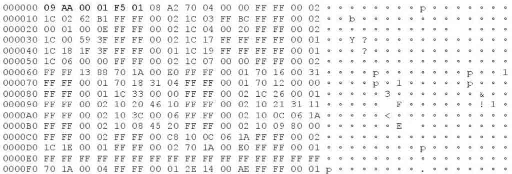

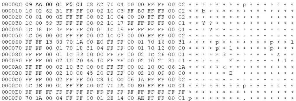

Looking at the .bin file I can see the first word, 0x09AA boot signature, followed by the application execution entry point 0x0001F501 which appears to be correct as in the .map output file.

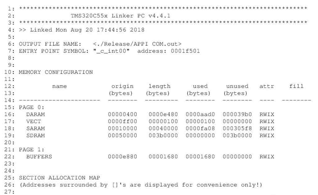

And the output .map file :
So when I power up the board the code does NOT execute from the programmed FLASH memory. I have included in the main() an infinite loop at the start to toggle some of the GPIOs so that I can measure on the oscilloscope any program activity after initial boot, but no such activity is observed. When I run the exact same application code with the infinite loop under emulation, all is fine. and the oscilloscope shows me the correct GPIO pin toggling.
