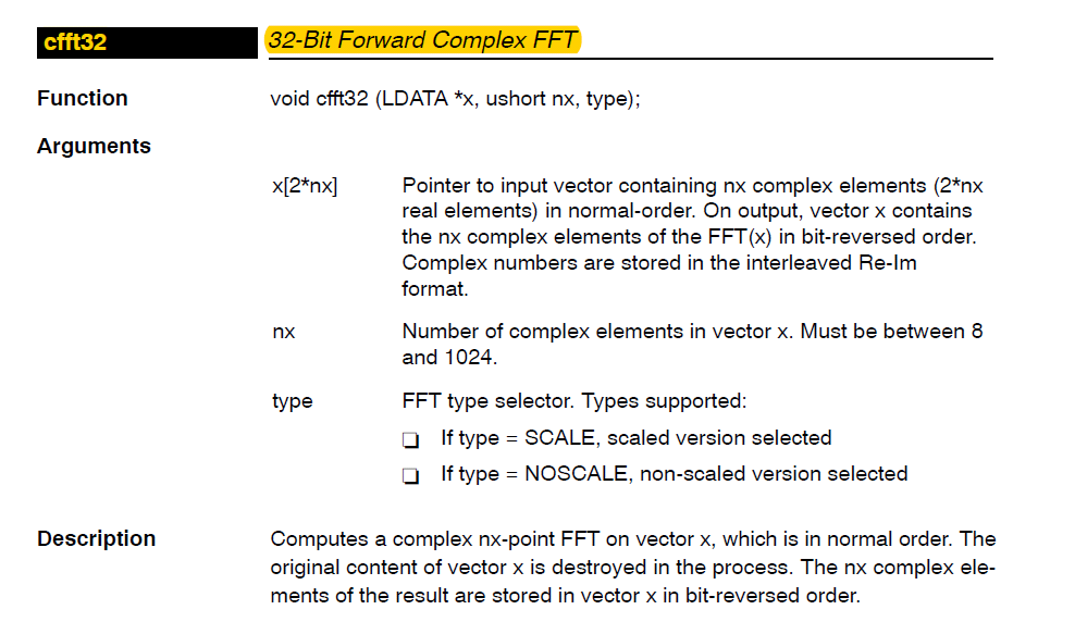

  • Hi Kanchan,
    The DSPLIB cfft32 function takes real and imaginary data in the fromat x[2*nx] where x is an array of 32-bit, Q31 fixed point numbers (LDATA) in normal-order. See excerpt from http://ti.com/lit/pdf/spru422 below.
    I'm trying to view the data in the graph window of CCS, but its not liking the Q31 number. Let me keep trying so I can confirm the real and imaginary extraction.
    Have you run through the example at in the DSPLIB? sprc100.zip\dsplib_2.40.00\EXAMPLES\cfft32\ (download at http://www.ti.com/tool/sprc100)
    Mark

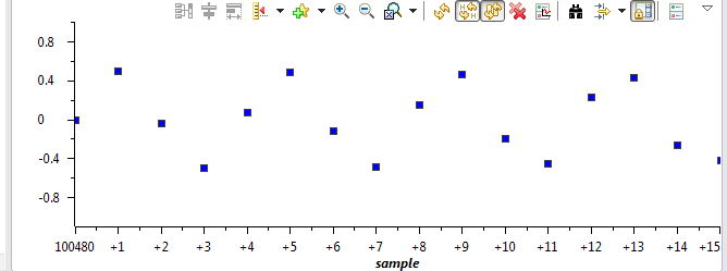

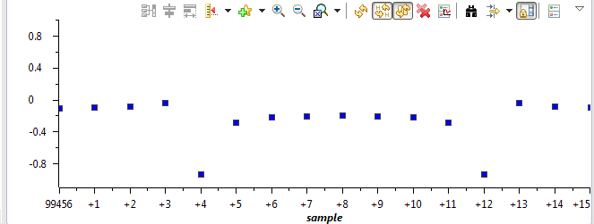

  • Hi Kanchan,
    I've confirmed the DSPLIB CFFT32 takes in data in the Real, Imaginary, Real, Imaginary order. Each Real and Imaginary part is signed 32-bit fixed point S32Q31 - decimal point between bit 32 and bit 31 for a range of -1 to 0.99999...
    To graph the data, I had to truncate the 32-bit fixed point to a 16-bit fixed point because the CCS graph tool cannot interpret Q31 for some reason.
    Attaching the modified cfft32_t.c and 55xdsp_5515.lib (rebuilt for cpu:3.3 - C5505/15/35/45/17 - using small mem model following steps on this E2E post https://e2e.ti.com/support/processors/f/791/p/86024/297465)
    /cfs-file/__key/communityserver-discussions-components-files/791/cfft32_5F00_t.c
    /cfs-file/__key/communityserver-discussions-components-files/791/55xdsp_5F00_5515.lib
    I used this matlab code to create a pure sinusoid tone and get the Q31 fixed point number to test the cfft32 with and then graph the result.
    Nsig = 16;
    fs = 16000;
    sig = zeros(1,Nsig);
    n = 0:(Nsig-1); % discrete-time grid
    %Add a pure sinusoidal tone
    fk = 4100;
    sig = .5 * sin(2*pi*n*fk/fs); %sinusoid
    sig_fixed = fi(sig,1,32,31);
    sig_fixed_hex = sig_fixed.hex;
    Graphing the truncated input looks like this
    Graphing the truncated cfft32 result looks like this
