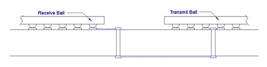

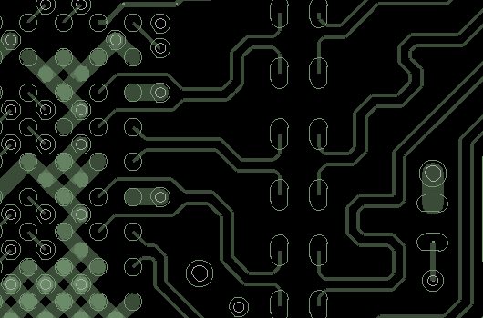

  • Hi.  My answers are below.
    1)      The routing described can be found on the C6678 EVM.  The information is on the Advantech website.  The receive pairs are on the outer two rings allowing these pairs to be routed away from the C6678 on the top layer.  To achieve this the pairs on the second ring need to split around the ground ball on the outer ring but this discontinuity shouldn’t be a problem.  This is shown below.

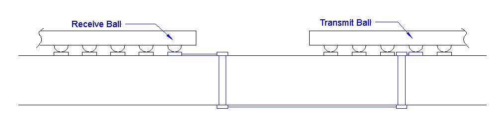

    1) I am aware of this example - the end of those diff pairs are routed to a connector.
    In Our design The hyperlink connects 2 DSP .
    The four shown diff pars are RX(0-3)  which should be  connected to the other DSP to TX(0-3) pins.
    TX(0-3) pins are in the 4th and 5th ring in the other DSP. and thus can not be reached by traces on top layer ( where the DSP is mounted )

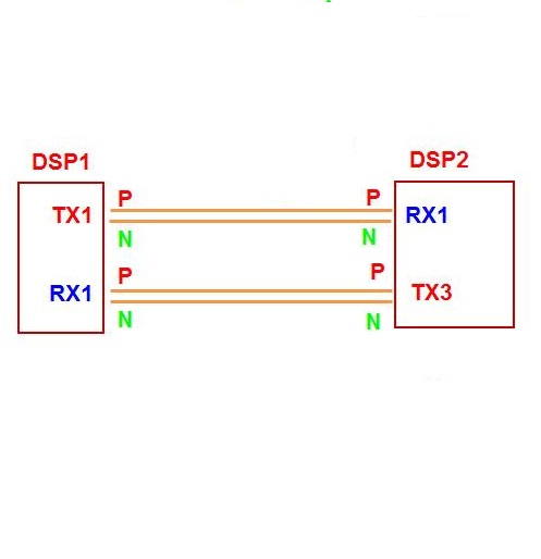

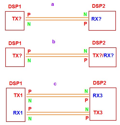

    7) see also item 1 : when you say "swap lanes"  to which of the option below you mean
    a) a TX from one DSP can be connected to any RX pins in the other DSP
    b) a TX from one DSP can be connected to any RX OR TX pins in the other DSP
    c)  2 pairs (lane) with same designation  (for example RX1 & TX1) from one DSP can be connected to the other DSP in other lane designation(for example TX3 & RX3 )
    while maintaining  that TX from one DSP is connected to RX in other DSP.
    In all variations P/N  can be swapped within the pair.
    see picture below

  • 1)      I was illustrating how you escape the receive pairs from the DSP.  The DSP to DSP example is similar to the example shown for the connectors.  In that case the transmit pair from the inner ring is dropped to the bottom of the board using the escape via.  The trace is routed on the bottom for a distance and then brought back to the top using a second via.  The trace is then routed directly to the receive balls.  The capacitors on the EVM were only included because of the connector.  They are not needed for DSP to DSP connection.

    7)      The interface supports auto polarity detection and correction as well as auto lane identification and detection.  This means the following.
    Auto polarity detection and correction allows the P&N of a transmit differential pair to be connected to an N&P respectively of the receive pair.
    Auto lane identification and correction allows the transmit and receive pairs from one lane to be connected to the transmit and receive pairs of a different lane.
    In the examples you provided the HyperLink can be connected as shown in example a and example c but it can’t be connected as shown in example b.  A Tx pair must always be connected to an Rx pair.

    1) I was sure that at least 4 diff pairs can be routed only on CS without the need for Vias
    But now i understand that all 8 Diff pairs will have 2 via and will be routed partially on TOP and partially on Bottom
    7) If we use all 4 Tx and RX pairs than only example c is allowed
    A lane which consists of one RX pair and TX pair with same designation can be swapped with other lane that has different designation
    In each pair P/N polarity can be changed

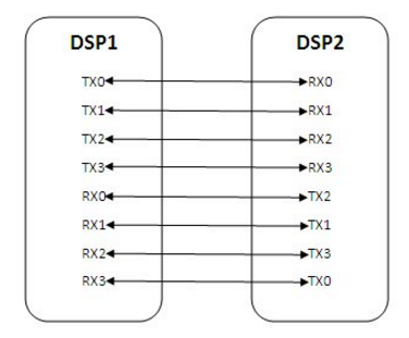

  • Hi Bill,
    We are designing the 6678 based Multi DSP board. We are thinking of using Lane swapping for Hyperlink . I have attached our configuration,please let me know whether it works or not  .
    Please confirm
    Sakthi.A

  • Hi Sakthi,
    I am sorry it took so long to get your answer but there were a number of team members that needed to be consulted. What I discovered is that a single lane of HyperLink cannot be connected as you have shown in your diagram. For all HyperLink implementations, all four lanes must be connected between the two DSPs. The HyperLink can disable the use of lanes to save power if only a single lane of throughput is needed, but all lanes must be physically connected between the two parts. This was not made clear in the Hardware Design Guide and I will update the guide to reflect this information.
    Bill
  • Hi Bill,
          We are going to use the lane swap for all four pairs. I have attached earlier only our concept of doing Hyperlink swap.   It made you to think differently. I have attached our actual lane swap concept with four lanes.
    Please find attached the swap image. Whether it is feasible or not . If it is  feasible ,please how the processor identifies the lane swap.Any registers to be monitored.
    Sakthi.A
  • Hi Sakthi,
    The lane swapping should not present a problem to the HyperLink interface. It will determine the connections and reassemble the data into the proper format at the far end. There isn't a set of registers that is provided by HyperLink to defining the swapping on the board. You will have to define a structure which identifies which DSP1 RX lane is connected to which DSP TX lane. You will need this information when running the software to tune the transmit and receive parameters for the SERDES interface.
    Bill
