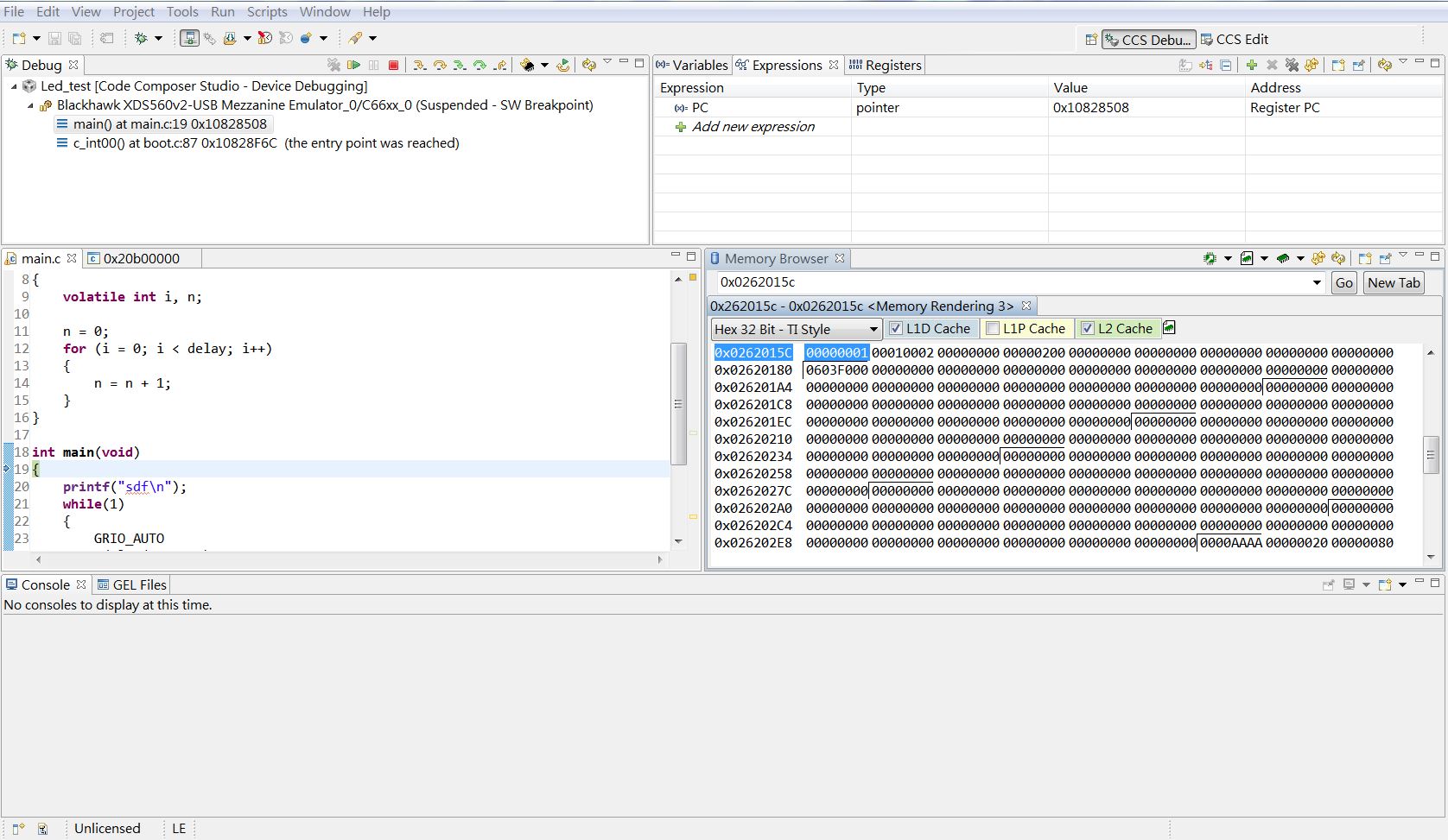

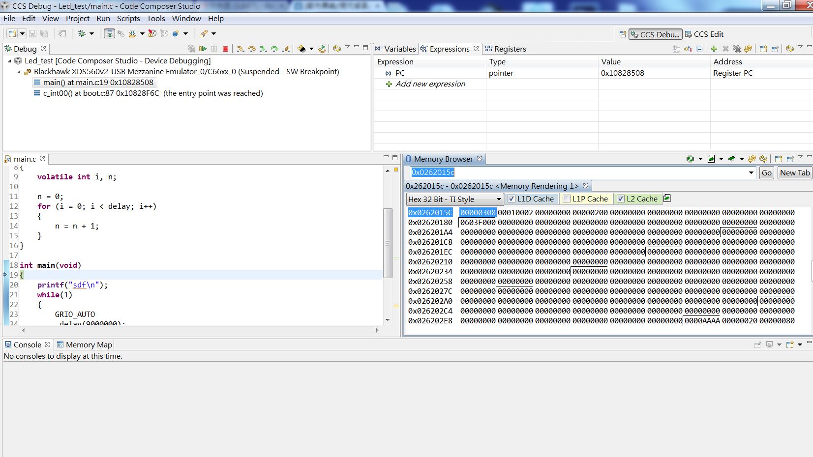

    Register 0x21801728   value: 0x20002800
    Register DEBUG0(0x21800728)   value: 0x00000000
    How can I check host could provide 100MHz PCIe reference clock?
    Target board : Gigabyte GA-8I945GMF
    popo.

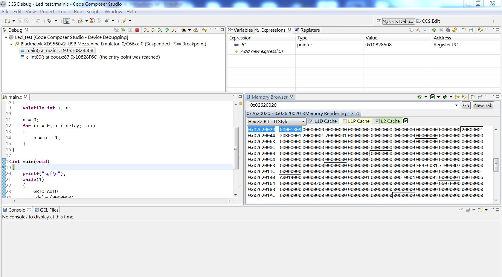

  • In reply to Steven Ji:
    Hi Steven,
    Thanks for your reply.

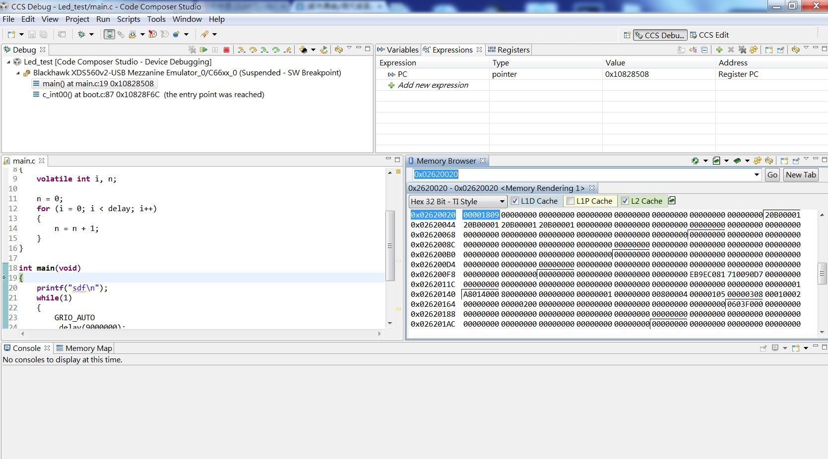

    1.
    PC value is0x00190c10
    PC value:
    0x21801728 value:
    PCIE datasheet Page 3-122:http://www.ti.com/lit/ug/sprugs6c/sprugs6c.pdf
    It says DEBUG0 offset is 728h.
    Is this correct or I see wrong datasheet?

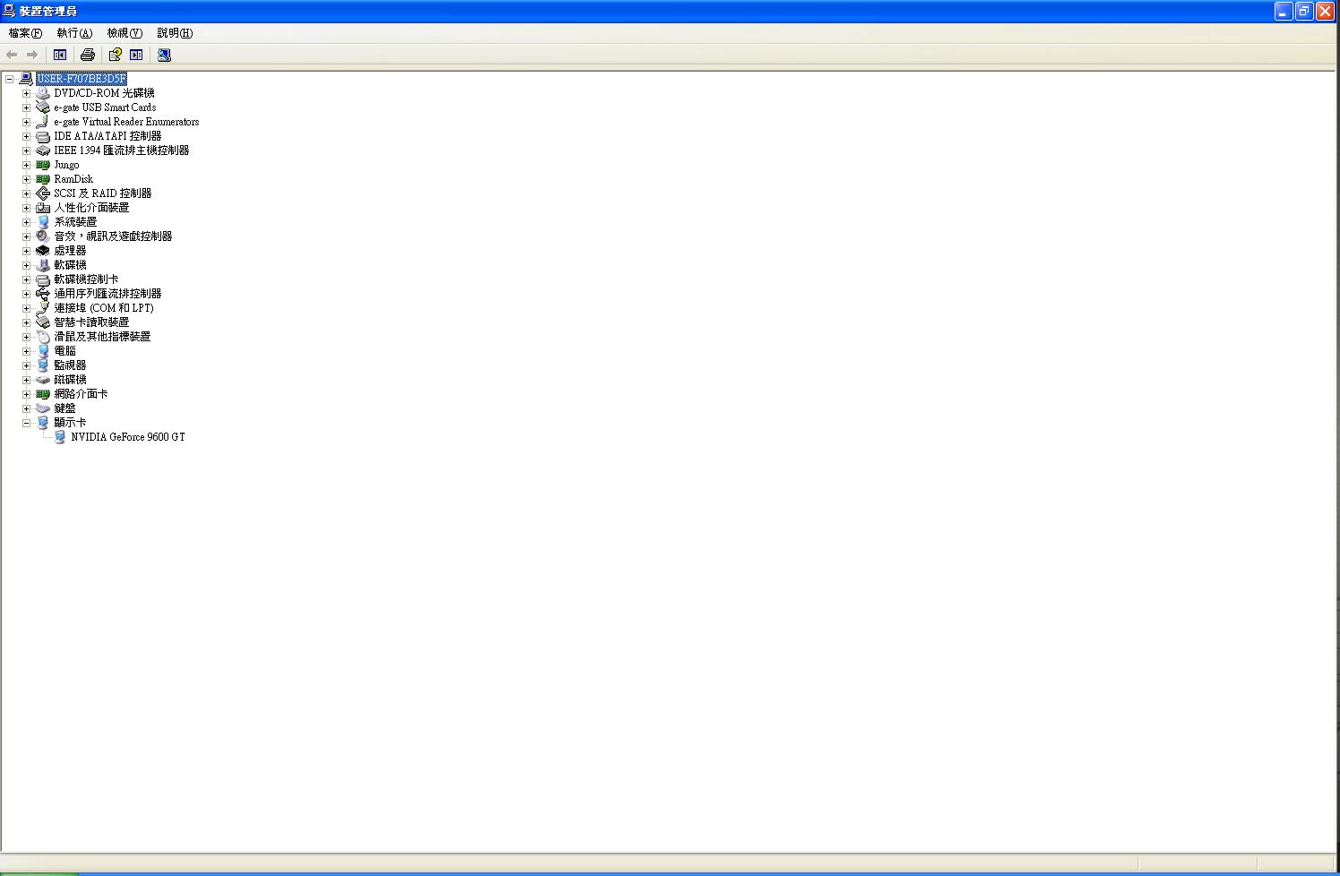

    2.
    I re-plug into the slot but it can't find new device.
    My system is: Linux Kerner 3.2.0-34 64Bits
    Best Regard,
    popo

    You can use the external power and in PCIe boot mode, WITHOUT putting the card into the host. Can you check where the Program Counter register in the CPU (should be 0x00800xxx in LL2) and DEVSTAT (address 0x02620020, value should be 0x00001809) with an emulator to make sure IBL is correct?

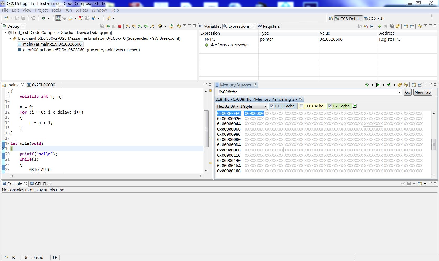

    Hi Steven,

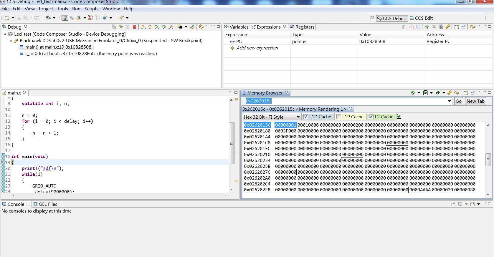

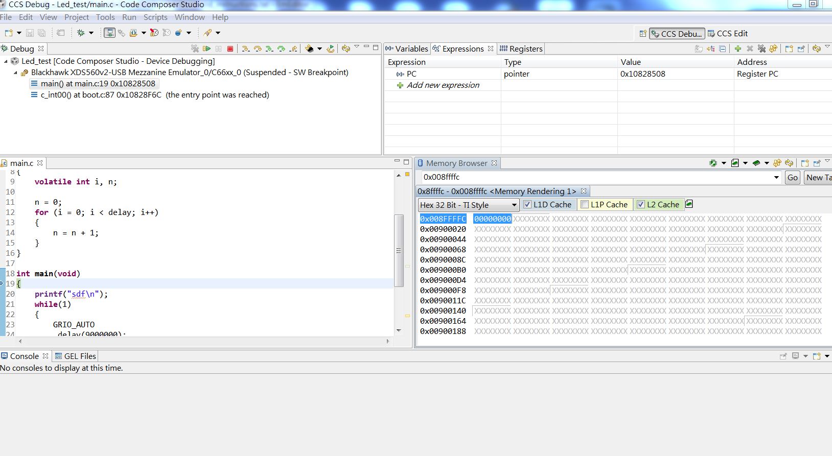

    I check register value and re-plug PCIe.
    I get below value but PCIe device can't find.
    PC and 0x02620020 register value:
    MAGIC_ADDR(0x008FFFFC) value:
    Best Regard,
    popo

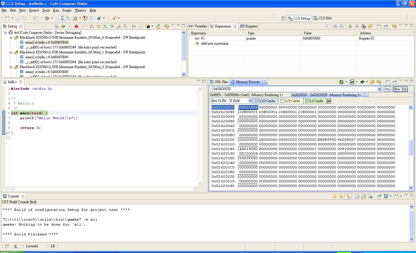

    I load "C:\ti\mcsdk_2_01_02_05\tools\boot_loader\examples\pcie\pcieboot_helloworld" lib file to C6670 DSP board and have correct switch Boot mode.
    Does it correct IBL file or not?
    But I can't use "lspci " command see any device in Linux host.
    When I use emulator to see memory register I got same result on Dec 20 2012 21:37 PM
    Best Regard,
    popo
  • In reply to demon popo:
    popo,
    What I suggested is not to load any test case into the device otherwise the PC register could be pointing to other place.
    So could you please repeat your register observation steps without loading "pcieboot_helloworld" file please?
    We should let the EVM run the boot code (IBL) only and see where it is stuck. Thanks.

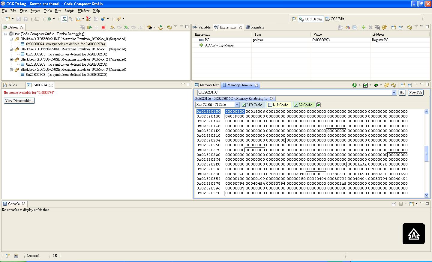

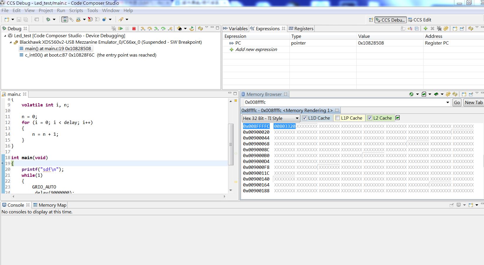

    Hi Steven,
    IBL file is:
    C:\ti\mcsdk_2_01_02_05\tools\boot_loader\ibl\src\make\bin\i2cparam_0x51_c6670_le_0x500.out
    C:\ti\mcsdk_2_01_02_05\tools\boot_loader\ibl\src\make\bin\i2crom_0x51_c6670_le.bin
    I update this file to DSP board but Linux host still can't find PCIE device.
    Register value:
    PC:0x00800974
    0x008FFFFC:0x00803320
    0x02620020:0x00001809
    Best Regard,
    popo
