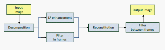

    3) Can you please provide some description on the "new algorithms" to be added in your system? Are they video codecs or something else?
    >>> They are image codecs.  FPGA will do image preprocessing and DSP will do critical image processing, such as image enhancement, target tracking. We haven’t decided the details completely.  The blocks of image enhancement algorithm are as follow.
    4) Can you please provide an overview of your system, such as the architecture and the data flow?
    >>>As the pictures show, multicore DSP receives image data from SRIO and processes it real-time. The processed results transmitted to other subsystems via SRIO and optical fiber. The entire processing system works under the supervision of master control center. Therefore, the data flow can be described simply: SRIO --> DSP --> Ethernet or SRIO --> DSP --> SRIO.
