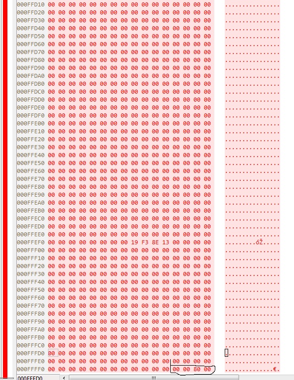

When I power my computer, the DSP is connected via PCIe connection and the switches are in ROM PCIE Boot. In this state I am booting with IBL (am i correct? I am using version 02 of FPGA).
I am loading my program and after changing the magic address nothing is happening.
1. Is the simple "wait boot" program to Core0
(which discussed here : http://e2e.ti.com/support/dsp/c6000_multi-core_dsps/f/639/t/272915.aspx)
is needed for booting process ? In my opinion, The IBL should handle the jump to magic value. Why do I need this simple "wait boot" program to Core0 ?
2. How can I load this simple "wait boot" program to Core0 without JTAG in CCS? For loading such a program I need to boot.
