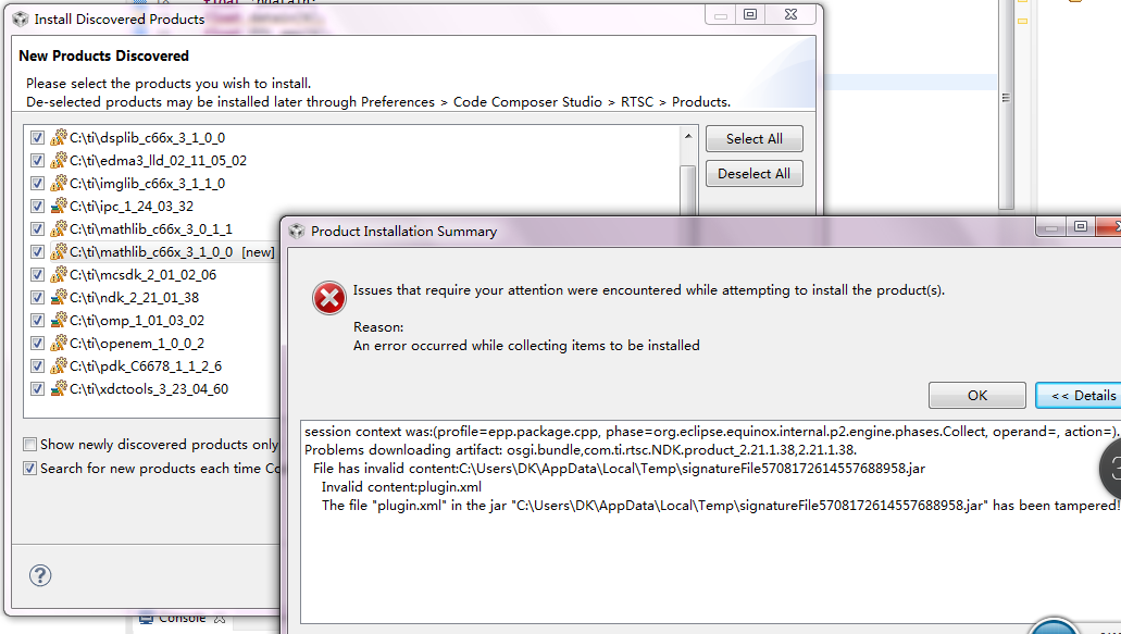

  • That makes sense, but I am getting some errors in CCS (5.5).  I installed MCSDK 2.1.2.6 and the patch on my Linux system.  When I restart CCS, it prompts me with a dialog to install the components, but I am getting various errors when attempting to install them.
    It appears as if another user has also had these issues in a post and recently indicated they are not resolved.
    Operation details
      Your original request has been modified.
        "SYS/BIOS (IDE Client)" will be ignored because a newer version is already installed.
        "IPC (Multicore and I/O) (IDE Client)" will be ignored because a newer version is already installed.
        "SYS/BIOS MCSDK" will be ignored because a newer version is already installed.
        "NDK (IDE Client)" will be ignored because a newer version is already installed.
        "Third-Party Components for GMF Runtime " will be ignored because a newer version is already installed.
        "RTSC/XDCtools (IDE Client)" will be ignored because a newer version is already installed.
      Cannot complete the install because some dependencies are not satisfiable
        com.ti.biosmcsdk.pdk.C6670.feature.group [1.1.2.6] cannot be installed in this environment because its filter is not applicable.
    Operation details
        com.ti.biosmcsdk.feature.group [2.1.2.6] cannot be installed in this environment because its filter is not applicable.
    An error occurred while collecting items to be installed
      session context was:(profile=epp.package.cpp, phase=org.eclipse.equinox.internal.p2.engine.phases.Collect, operand=, action=).
      Problems downloading artifact: osgi.bundle,com.ti.rtsc.NDK.product_2.21.1.38,2.21.1.38.
        File has invalid content:/tmp/signatureFile2656870264997269363.jar
          Invalid content:plugin.xml
          The file "plugin.xml" in the jar "/tmp/signatureFile2656870264997269363.jar" has been tampered!
    Operation details
        com.ti.biosmcsdk.pdk.C6657.feature.group [1.1.2.6] cannot be installed in this environment because its filter is not applicable.
    Operation details
    Operation details
        com.ti.biosmcsdk.pdk.C6678L.p2.feature.group [1.1.2.6] cannot be installed in this environment because its filter is not applicable.

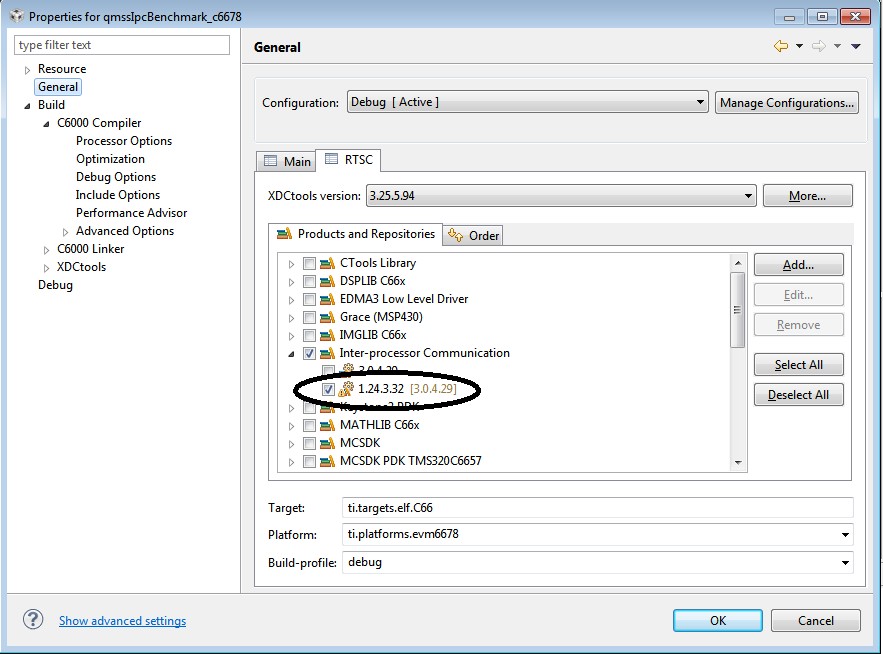

    While creating/building project for Keystone I devices, please ensure to use the correct RTSC product version from the project configuration below.
    For Example:
    Import IPC example project from, ..\pdk_C6678_1_1_2_6\packages\ti\transport\ipc\examples\qmssIpcBenchmark
    That uses the old IPC package. Please ensure that correct IPC is selected by checking the project properties before building.
    Right click on project -> Properties -> General(Left Panel) -> RTSC
    Thank you.
  • The products that are listed in the dialog on my installation are shown below.  They are different than the ones shown in your case.
    When I import that project, I get an error and am unable to build it due to that same error:
      Unrecognized product of type 'com.ti.biosmcsdk.pdk.C6678L' is required by project 'qmssIpcBenchmark_c6678' - please install at least one product of this type before building this project.

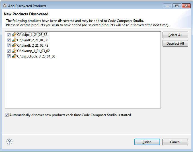

  • Hi Matt,
    Could you please provide the screenshot of discovered products in your case?
    Thank you.
  • Hi Matt,
    I could not see the attachment in your previous post. I would suggest you to post this query in CCS forum for faster response.
    Thank you.
  • Please see the attached aggregate image of the discovered products.
    I originally posted in the CCS forum, but the moderator moved it to this forum.
  • Again, I am getting a different set of components that did not install correctly, specifically the ones required for the keystone I platforms.  When I try to import one of the example applications from that package and it will not build.  The products I am interested in did not seem to install correctly where as in your case, the keystone I products did.
