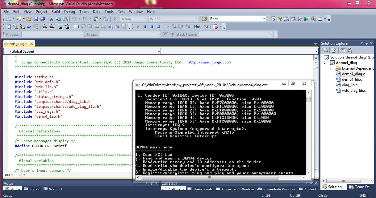

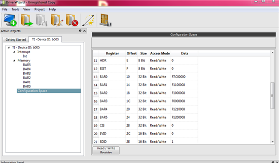

        DSP Inbound address configs BAR1(0xF1400000) to DSP's dstBuf.buf(0x10820E00). The PC can read/write DSP's dstBuf.buf(0x10820E00) by reading/writing from/to BAR1(0xF1400000). It seems that the Inbound transaction works fine.
        Now I'm going on debugging the Outbound. DSP Outbound address is configed to BAR3(0xF0000000).
        In PC, a dataBuf is allocated to accept the data sent from DSP.
        Should PC do some Inbound translation to config the address of dataBuf to BAR3(0xF0000000)? What settings should be done in PC in order to accept the data sent from DSP?
  • Hi Fan,
    Please share your test project. I will try to understand your test code and give possible solution.
  • Hi, Ganapathi:
        Thank you very much for the reply.
        The attached project is the pcie_exampleProject which I modified the Inbound and Outbound settings. I'm trying to use this project to communicate with PC( with Os Win7 64).
        In the Inbound settings, the DSP's dstBuf.buf(0x10822200) is set to BAR1(0xF1400000).
        The Outbound address is set to BAR3(0xF0000000).
        I have already successfully used the software WinDriver on PC(with Os Win7 64) to read/write the DSP's dstBuf.buf. In WinDriver I wrote 0x12345678 to BAR1(0xF1400000) with offset 0, then I can get the data 0x12345678 at the address of DSP's dstBuf.buf(0x10822200). The attached "C6678 BAR0-5.docx" shows the results, which proves that the Inbound works fine as I talked before. So the PC(with Os Win7 64) can read/write from/to the DSP.
        Now what I want to do is to realized the process that the DSP read/write from/to the PC(with Os Win7 64). The Outbound settings is done in DSP, which is set to BAR3(0xF0000000). I want to know what settings should be done in PC(with Os Win7) in order to receive data from DSP.
        I also attached the WinDriver software(which could be used freely for 30 days without registration). Hope you could understand my questions and help me. Thank you!
