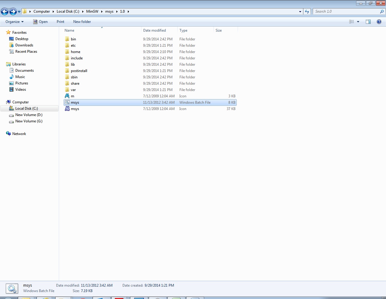

Hi,Ganapathi Dhandapani

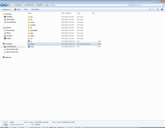

I have installed the MinGW as picture show
but next step how to use it build the IBL? The Build Instructions said Modify the environment setup script to match the tool chain installation directory, the setupenvMsys.sh code as follows

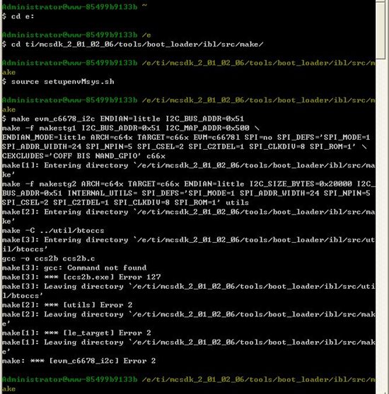

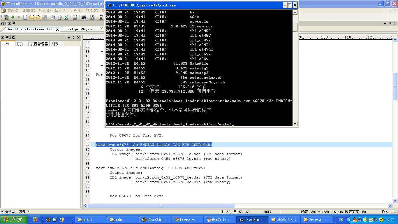

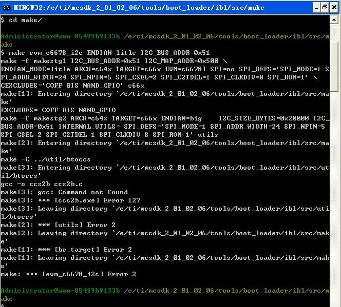

Another question, how to build it . I enter the cmd, type the order, but unable to build.
Please help!

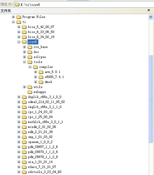

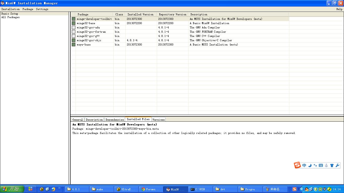

My install CCS file as below:
I can not found C6000 Code Generation Tools 7.2.4. I wonder whether can set
export C6X_BASE_DIR='"E:\ti\ccsv5\tools\compiler\c6000_7.4.1"
Hi Yuan,
I think you missed "source setupenvMsys.sh" command.
please follow the below step for building IBL source
1. Open MinGW MSYS build window
2. Change directory to \ti\mcsdk_2_01_02_06\tools\boot_loader\ibl\src\make
3. Modify the environment setup script to match the tool chain installation directory(I think you already done for "E:\ti\ccsv5\tools\compiler\c6000_7.4.1"
4. Run "source setupenvMsys.sh" command to set the environment variables.
5. Run "make evm_c6678_i2c ENDIAN=little I2C_BUS_ADDR=0x51" command to build your IBL source.

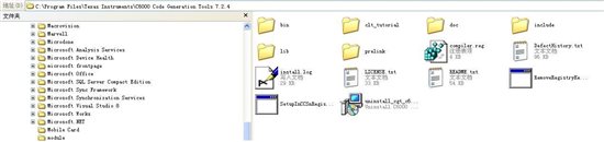

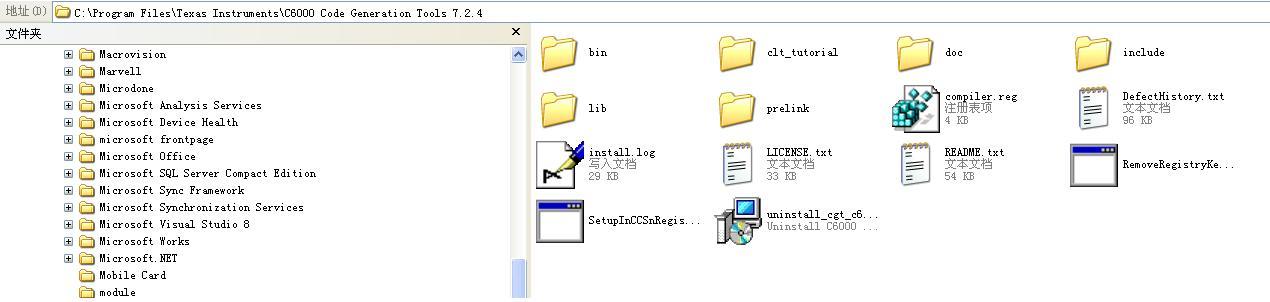

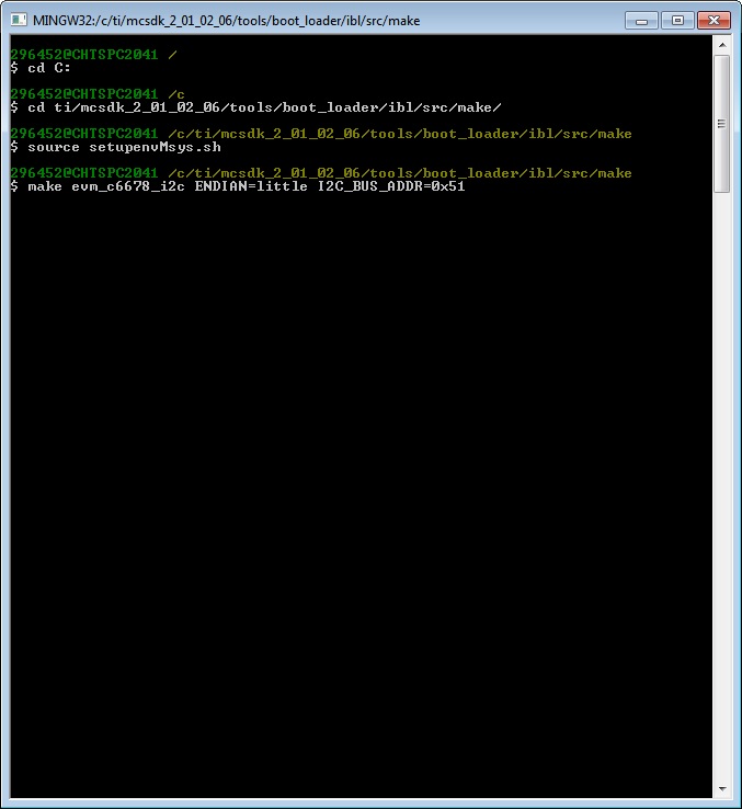

I retry the steps, but it appears the same phenomenon.
I load the boot_loader file, please help to find the problem
Hi Yuan,
I think c6000 compiler environment variables are not properly imported on your setup.
Please refer below link and install C6000 Code Generation Tools v7.2.4 on default diectry(C:/Program Files/Texas Instruments/C6000 Code Generation Tools 7.2.4).
http://software-dl.ti.com/codegen/non-esd/downloads/download.htm
