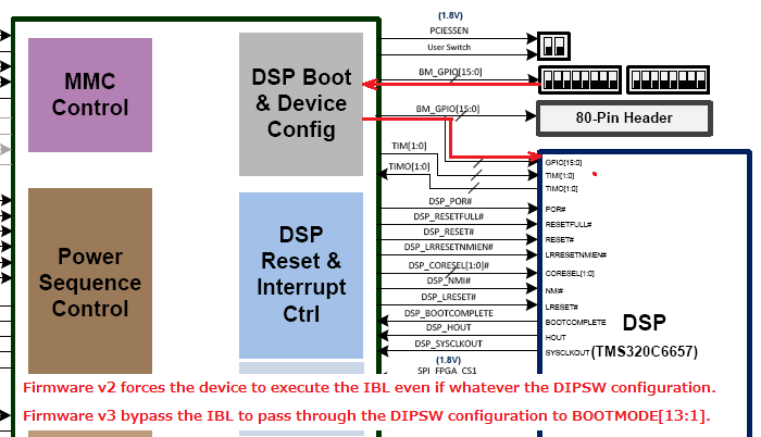

  • Rahul-san,
    I am very grateful to the valuable advice.
    I accomplished the NAND boot with your example.
    And, FPGA firmware update from V2 to V3 made me the result to jumping the program counter to 0x70000000 with NOR boot configuration.
    I attach the capture image.  (I don't connect the NOR flash daughter board in the exam below.)

  • Rahul-san
    Thank you so much for your support!
    I found FPGA firmware in eInfo chips site. Sorry for my not enough pre-searching.
    I read the EVM's TRM. But, there is no directions to update FPGA firmware.
    Since there is no detail about reason to update it, I can not understand why the DSP boot succeed by FPGA firmware update.
    Do you know below?
    - What is firmware v02 for?
    - What is the meaning of FPGA firmware update as for NAND boot?
    I would like to confirm that FPGA firmware version depends on all the causing.
    And, I would like to confirm it is true that C665x have no restriction to boot from EMIF16 boot.
    Best regards, RY
  • The Gauss EVM comes with a secondary bootloadxer (IBL) that is written on the I2C EEPROM that is on the EVM. The FPGA firmware v2 forces the device to execute the IBL before it can execute any other code. This is a requiremnt for most of the Out of box demos on the EVM.
    Firmware upgrade to v03 allows user to bypass the IBL and boot natively from the boot media using the Rom code on the device.
  • Rahul-san,
    Thanks for your comment!!
    I understand the mechanism below.
    Is my understanding correct?
    Best regards, RY
  • Yes, your understanding is correct.
