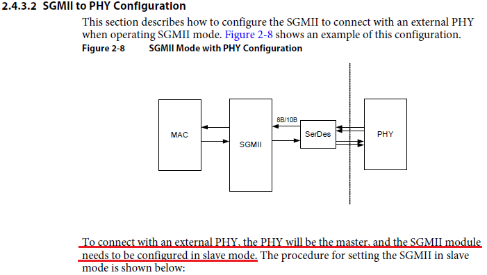

  • We could succeed ping by 66AK2H12 + 88E1512.
    I modified configuration:
      66AK2H12:
        SGMII_CONTROL->MASTER = 0x21 // master mode, auto-negotiation enable
        MR_ADV_ABILITY = 0x9801 // Full duplex, Speed Gig
      88E1512:
        Configured as Slave
    On my exam,
      When SGMII is slave mode (PHY is master), ping was failed.
      When SGMII is master mode (PHY is slave), ping was succeed.
    The default MCSDK for K2HEVM configures SGMII as slave mode. (using 88E1111)
    And, KeyStone Gigabit Ethernet UG describes that SGMII module needs to be configured in slave mode to connect with an external PHY.
    Question)
      - To decide master/slave mode, are there any rules?
        (Because, UG describes that SGMII needs to be slave.)
      - EVMK2E has 88E1514. Is the SGMII module configured in slave mode?
    Best regards, RY
  • Hi, RY,
    Defining the SGMII port to be master, it might be taking advantage of some arbitrary power-on state which makes it working, but the stability of this solution is questionable. SGMII is a MAC-to-PHY link as defined by the IEEE.  In an implementation of a K2H connected to an Ethernet PHY, this is the defined use case.  IEEE defines the PHY as the master of the SGMII link and the MAC as the slave on an SGMII link.  This allows the PHY to negotiate the PHY-to-PHY link over the cable and then to present these capabilities to the MAC.  If the MAC is defined as the SGMII master, this end-to-end link functionality is broken. 88E1512 can be used like the K2E EVM but will need MDIO support to get the PHY to link up.
