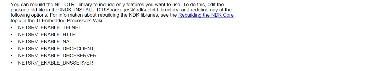

  • Ping Wang,
    The Network Client Example Application:
    The client example application also includes a console application with several tests and status query
    functions available. In order to get to the console, simply telnet into the application's IP address.
    Note that the console program will timeout and disconnect after a period of inactivity.
    To get a list of console commands, type help or simply ?. This action prints a list of console commands to
    the telnet terminal.
    The console program is important as a programming demonstration as much as a run time demonstration. There are many functions in the console program that display or test features particular to the NDK.
    When an application developer wants to use these features in their application, the console example source code can be useful as a guide.
    The similar discussion is happened on the below E2E post, this will be useful.
    http://e2e.ti.com/support/dsp/c6000_multi-core_dsps/f/639/t/257121.aspx
