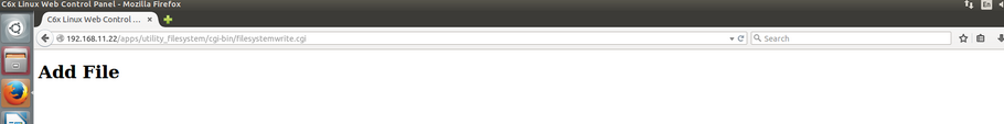

Help me please!!! I try to use Matrix-gui-2.0 file system utility for write file to EVMk2H file system, it works fine with files less than 16M size, but if i choose file with size 17M for example, only first 16.5M is being written. What can be a problem?

  • I work with NFS booting. After EVM is On I open internet browser page of matrix utilities (Matrix App Launcher v2 p1) on host machine , go to 'Utilities'->FileSystem Utility->Run. I set Remote Filename /home/root/a and I browse for local file. That is all.

  • Hi Shankani, thanks for your answer!!!! The problem does not look as communication problem, You are right, the utility was written for delivering small files, I opened filesystemwrite.cgi file, the parameter 'bs' (block size) of 'dd' command on the line 49 is set to 1, so it will take a lot of time to deliver large file. I tried to change it on larger value and it works, but still not for large files. In order to DEBUG the issue I printed 'fsize' value, which is calculated before writing file into filesystem and I got wrong value.
    Actually I do not get any error, just empty result page and file, written to filesystem with smaller size.
    Can it be the problem of web server (lighttpd) configuration????

    It could work for just 16MB and it is depends on "tmpfs" size ie 16MB to "/var/volatile"
    If you want to write more size in MB then you may need to change "/etc/fstab" for "/var/volatile" entry.
