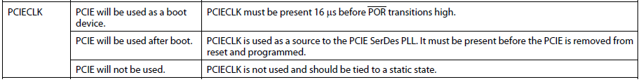

    The power sequence is different between prototype and my current board. In the prototype it was the EVM and it used the standard startup sequence. I have attempted to do the equivalent startup, but it could possibly be a problem area. Is it mandatory that the PCIe reference clock is stable before the DSP is powered or brought out of reset?
    Please refer the below table extracted from HDRG.
