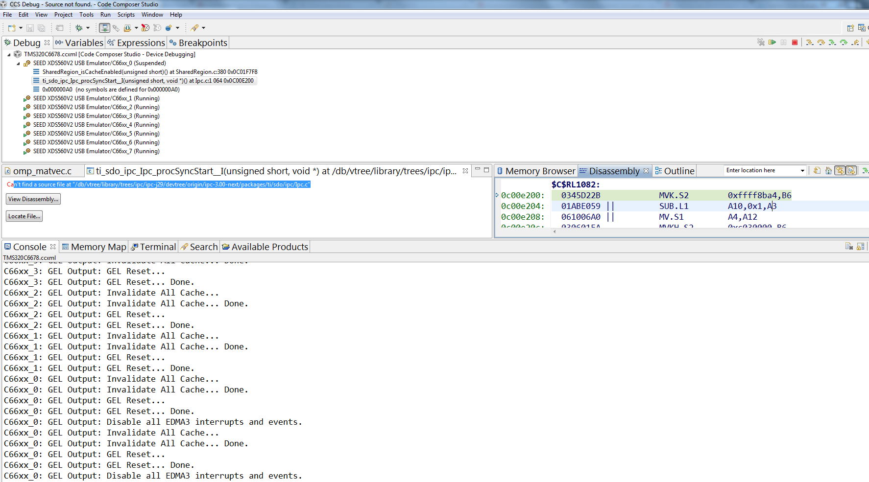

I trued run OMP exapmle with ti.omp.examples.platforms.evm6678 and receive
with ti.omp.examples.platforms.evm6678_ddr all examples run successfully
My question - this is contradiction into documentation or I understand something wrong?

  • Oleg,
    OpenMP requires that the 'dataMemory' be placed into a shared memory that is non-cacheable. The physical memory range for MSMC (0x0C000000-0x0C3FFFFF) is by default always cacheable. The MAR registers for the MSMC memory range are READ ONLY which means that the cacheability cannot be changed.
    Knowing this we have two options:
    1. Set the L1 and L2 caches to 0k and access the MSMC through its physical address range (0x0C000000 - 0x0C3FFFFF)
      1. This is the method that you are referring to from the user guide
      2. Since there are no caches then none of the memory accesses to the MSMC, or the DDR for that matter, will be cached
    2. Create a virtual address range that is non-cacheable that points to a portion of the MSMC's physical memory range.
      1. This is the method that the provided examples use
      2. In the platform.xdc file that you copied from above you can see that a virtual address range is being used to access part of the MSMC memory.
      3. In this case 0xA0100000 - 0xA03FFFFF is an alias for the physical MSMC memory range 0x0C100000 - 0x0C3FFFFF
      4. The MAR registers for the 0xA0100000 - 0xA03FFFFF address range are configured to be non-cacheable so any MSMC memory access through this memory range will not be cached regardless of the size of the L1 or L2 caches
    Jason Reeder
