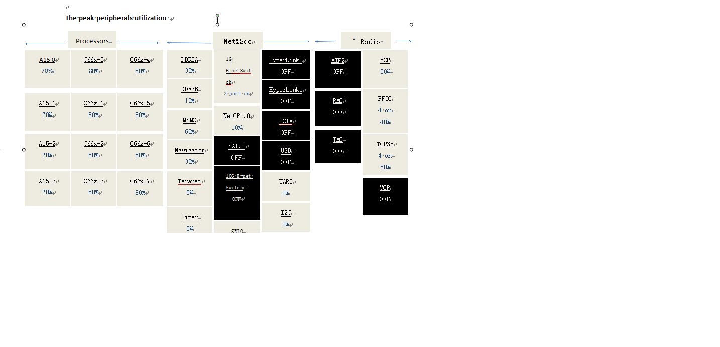

  • Hi Vaibhav,
        I just evaluate according to consumption sheets pointed by Raja sufficient.I need your help an more  accurate evaluation.
    The information of our product is as follows.
    USE Case Condition /Assumptioms
    -Application                                              =LTE
    -Case Temperature                                =100℃
    -CPU Operating Frequency               =1200 MHz [Both ARM and DSP]
    -Supply Grouping                                 = CVDD;CVDDT
                                                                            CVDD1;CVDDT1
                                                                           DVDD18;DVDD15
                                                                              DVDD33;VDDA
    -External SDRAM                               =DDR3A/B@1600MTps
    -Peripherals Utilized                         =DDR3,SGMII,SRIO
    -Peripherals Not Utilized                =Hperlink,AIF2,PASS,PCIe,USB,10GbE
    The peak peripherals utilization
    The normal peripherals utilization
    Thank you.
    Hengwei

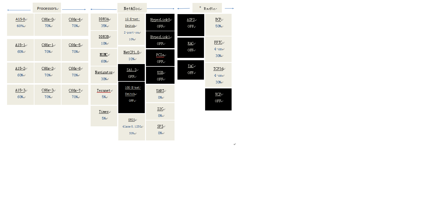

    -Application                          =LTE
                                          CVDD1;CVDDT1
                                          DVDD18;DVDD15
                                          DVDD33;VDDA
    Thank you.
    Hengwei
