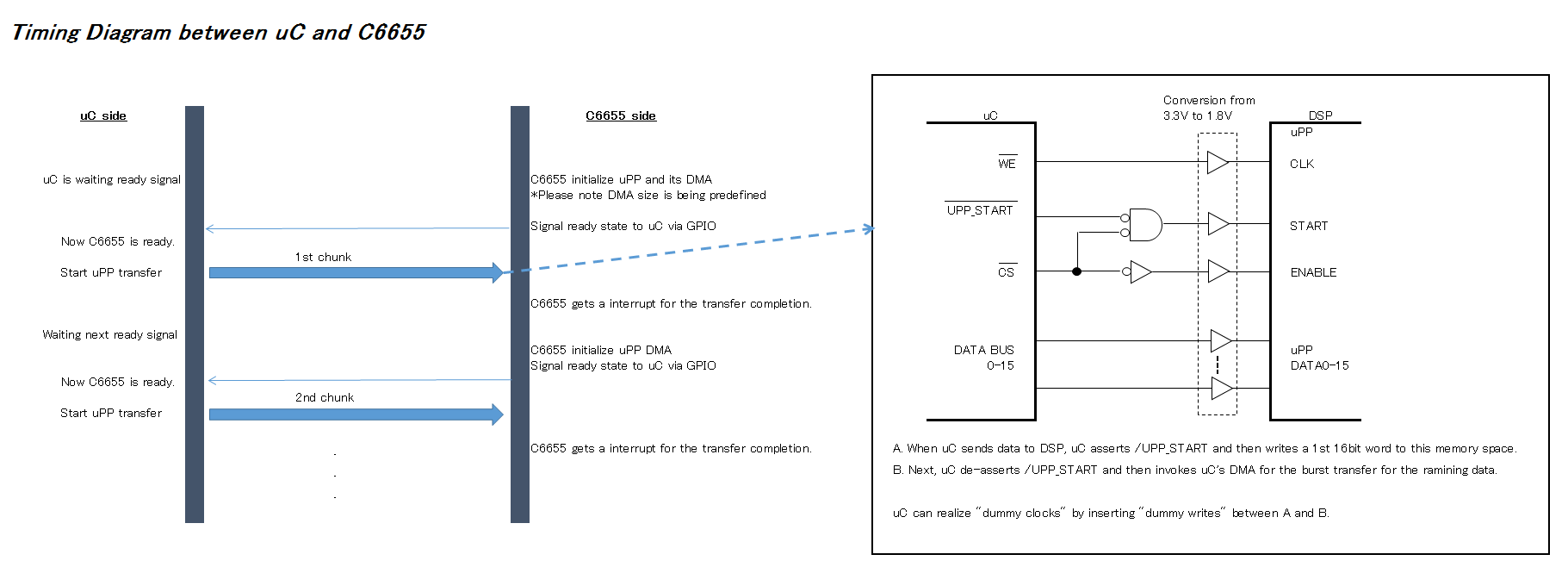

  • Hello Tom,
    Here is timing diagram. Do you have any comments on this ?
    In the meanwhile, I'm asking the customer to insert "software delay" before signaling GPIO to get the time margin for uPP DMA setup.
    uPP might not be actually "ready" state to accept incoming data because of something uPP HW setup time restriction or something SW inconsistence.
    Naoki

  • Naoki-san,
    We still need more information to help diagnose the problem.  Perhaps a logic analyzer capture showing all of the signals with enough zoom to see the actual timing and sequence of events.  Actually, we may need to see multiple.  The first needs to show the beginning of the transfer.  The second needs to show the steady-state transfer when it is working.  The third needs to show the transfer that fails.
    Tom

  • Naoki-san,
    The customer implementation is discontinuous.  They are trying to use the UPP as a slave asynchronous memory interface.  The UPP is designed to transport synchronous streams of data.  Solutions like their work-around of adding dummy clocks may be the only means to make this work.  However, it may still might not be robust.  Please refer to Figure 2-4 and 2-5 in the UPP UG SPRUHG9.  You can see that the clock is continuous and that the when in receive mode, the ENABLE signal qualifies the DATA as being valid.  You can also see in the transmit mode, the WAIT input must be pipelined one clock before the TX data halts.
    Tom

  • Naoki-san,
    Similar to the need for dummy clocks to pre-load the synchronous state machine to make the WAIT signal go inactive, I believe the dummy clocks at the end of the burst are needed to initiate the DMA.  Unless additional logic is added to make this a continuous, streaming clock interface, I believe the only solution is addition of dummy clocks both before and after each 64-byte chunk of data.  Does the customer achieve robust operation with these added?
    Tom
  • Naoki-san,
    In addition to the need for a continuous clock, as Tom described above, it is also a requirement that the WAIT signal be included in the UPP logic as stated in Table 2-5. The WAIT signal is generated by the C6655 and can go high to pause the receive transfer. If the WAIT signal is set high by the receiver, all data transfers will be ignored until the WAIT is set low. The transmit side is responsible for monitoring the WAIT and pausing the data transfer if the WAIT is set high. Based on the results observed, it also appears that the WAIT needs some input clocks to cycle through its state machine. In a system with a continuous clock, this will always occur. In the customers implementation, they might need to perform dummy writes until the WAIT is set low.
    Bill
