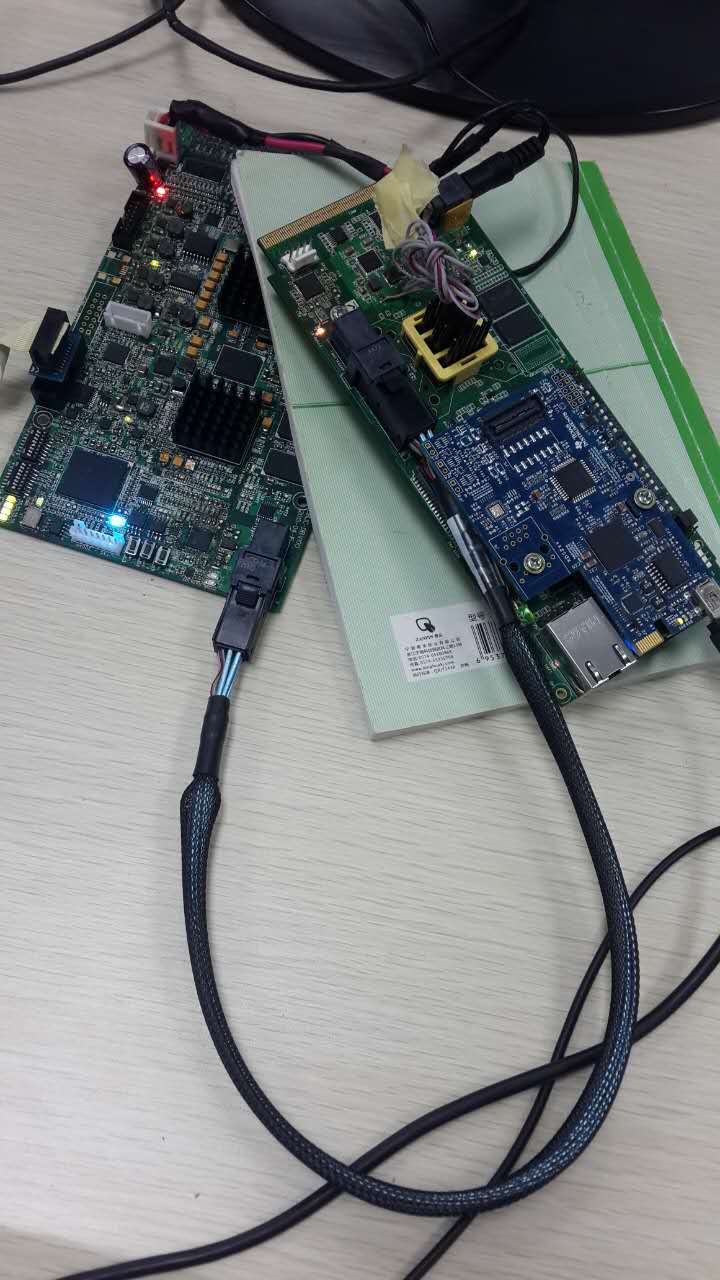

EVM and custom board connected by Hyperlink
 Import the project to CCS
 Set the boot mode of the device on EVM to no boot.
 For test between two DSPs,load the program to core 0 of first DSP, and load the program to core 1 of the second DSP.
 For test between two DSPs, run the core 1 of the second DSP firstly and then run the core 0 of the first DSP.

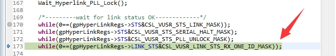

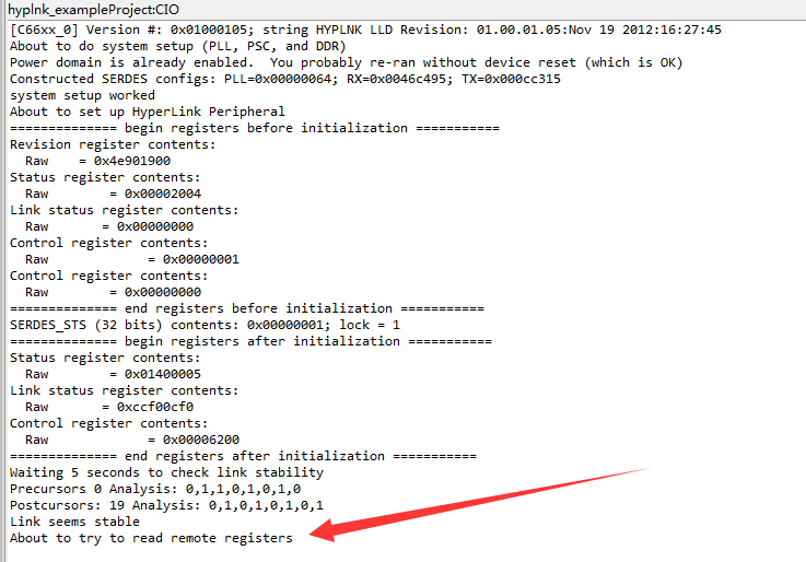

But the program stop here
WHY?WHY?WHY?

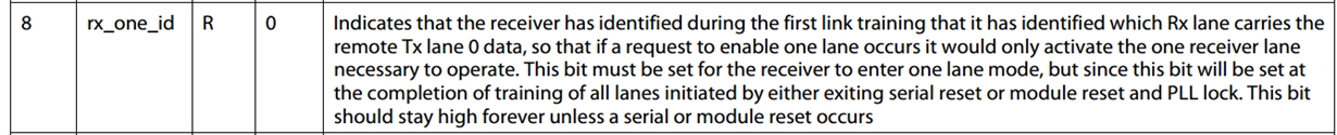

What is the role this one?
