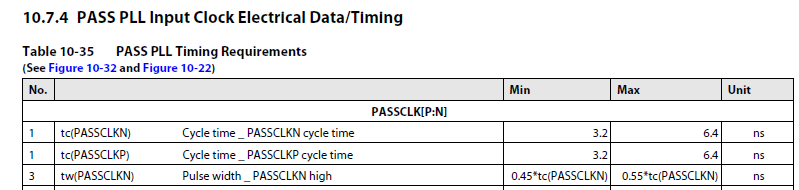

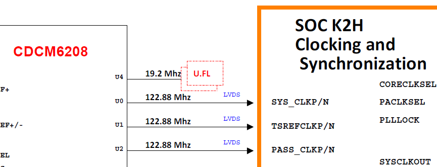

I have check K2H evm. Both  K2H TSREFCLKP/N and PASS_CLKP/N are 122.88Mhz. cycle time is 8ns.
But from datasheet the max of passclk cycle time is 6.4ns, does evm make a mistake?
And I can't find TSREFCLKP/N timing define. could you please help to check it?
thanks!
