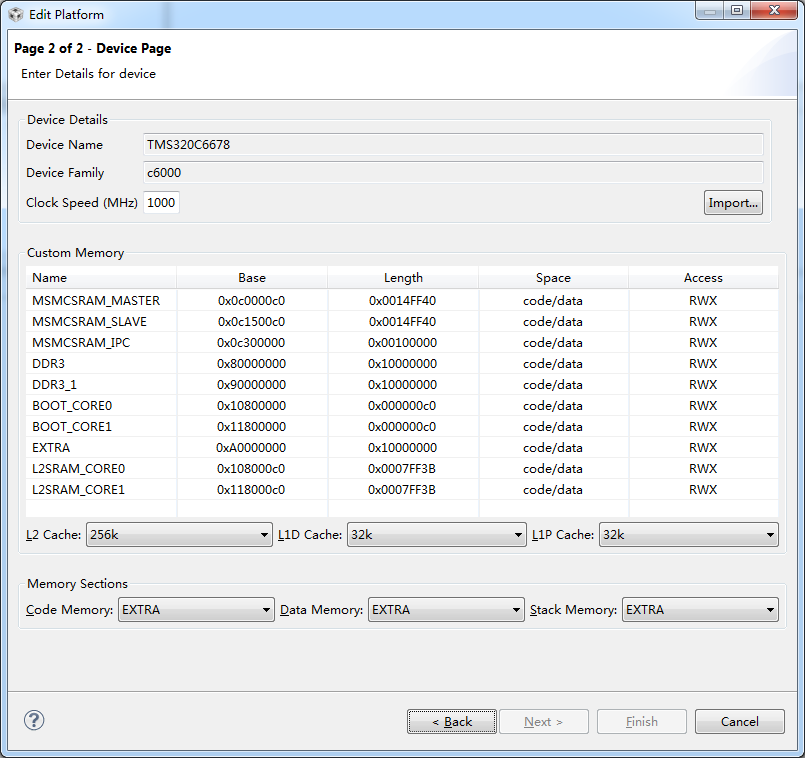

here is my platform setting
____
var heapMemParams = new HeapMem.Params();
heapMemParams.size = 0x8000000;
heapMemParams.sectionName = "systemHeapMaster";
Program.global.heap0 = HeapMem.create(heapMemParams);
Memory.defaultHeapInstance = Program.global.heap0;
Memory.defaultHeapSize = 0x1000000;
Program.heap = 0x1000000;
Program.sectMap["systemHeapMaster"]     = "DDR3";
____
the above is all the relative heap setting in the .cfg file of core0
since the project is modified based on the MCSDK demo, i can't get fully understand of all these settings
and the reason why the handle is at the address of L2SRAM
thank for the notice and help

    the setting about DDR in .cfg file of core0 is as follow:
    /* Create a Heap. */
    heapMemParams.size = 0x8000000;//0x8000000;
    DDR3 is set on platform with 0x1000 0000 length
    setting in core1 is similar with it

  • Hi Rajasekaran K,
    I think it is not the problem of initialization of DDR3
    First, I have tested the LED test project with the (.text) part allocated on DDR3,  while the LED flashed correctly.
    .cmd file of LED project is like this
    ______
    MEMORY
    DDR3 : o = 0x80000000,   l = 0x01000000
    SECTIONS
    .text > DDR3
    ______
    Second, in the process of changing the .out into .dat file, I have used the AddDDrTable.exe
    the .cpp of this program is in the accessory
    AddDDrTable.cpp
    However,
    After I examine the .map file of the project, I found
    10818510    00000018     image_processing_evmc6678l_master_pe66.oe66 (.fardata:ti_sysbios_heaps_HeapMem_Object__table__V)
    It is included in (.fardata.2), and the ERROR infomation shows that the handle is at 0x10818510
    would it be useful if I move this part to DDR3 by adding
    image_processing_evmc6678l_master_pe66.oe66 (.fardata:ti_sysbios_heaps_HeapMem_Object__table__V) }"] = "DDR3";
    looking forward to your reply
