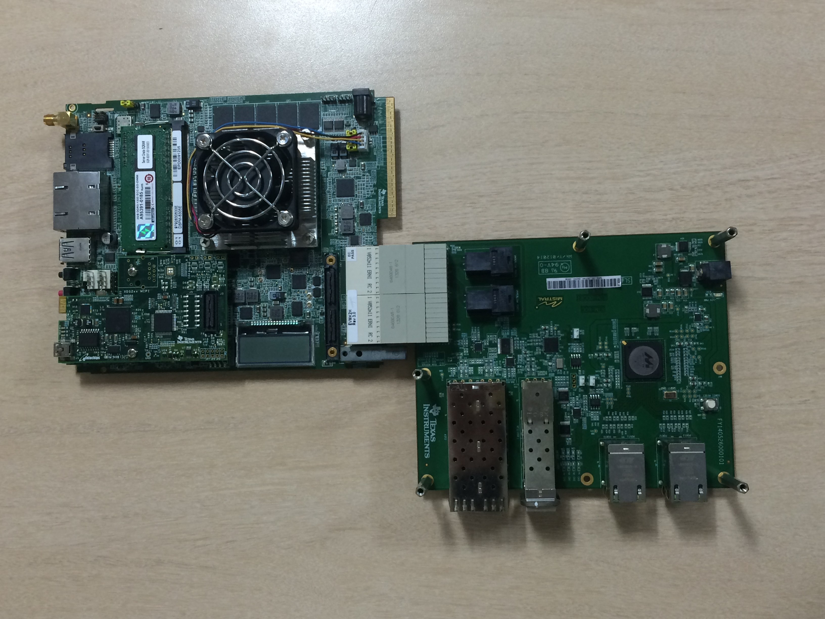

    You can able to directly connect the RTM-Break-out Card and K2Hx EVM and validate the 10GigE, Hyperlink, and AIF2 subsystems of the Keystone II SOC on the EVMs. see the below image for RTM-Break-out Card and K2Hx EVM connection setup.

    I have another question. From your picture, the RTM is faced up connecting with K2H. Can I make the RTM face down connecting with K2H without changing K2H position? The reason of asking that is the Edge B of K2H is the top of MTCA chassis, and AMC(Edge A) is the bottom side. So we need to make sure the RTM is not out of shape of MTCA chassis.
    The last question. are there any Edge B extension cable or converter can help us to connect RTM to K2H? Are there other kinds of RTM board for K2H EVM available on the market?
    No. RTM BOC only compact-able for above my image. It does not support your requirement.
    No. TI has recommended only RTM-Break-out Card for validate the 10GigE, Hyperlink, and AIF2 subsystems of the Keystone II SOC on the EVM.
