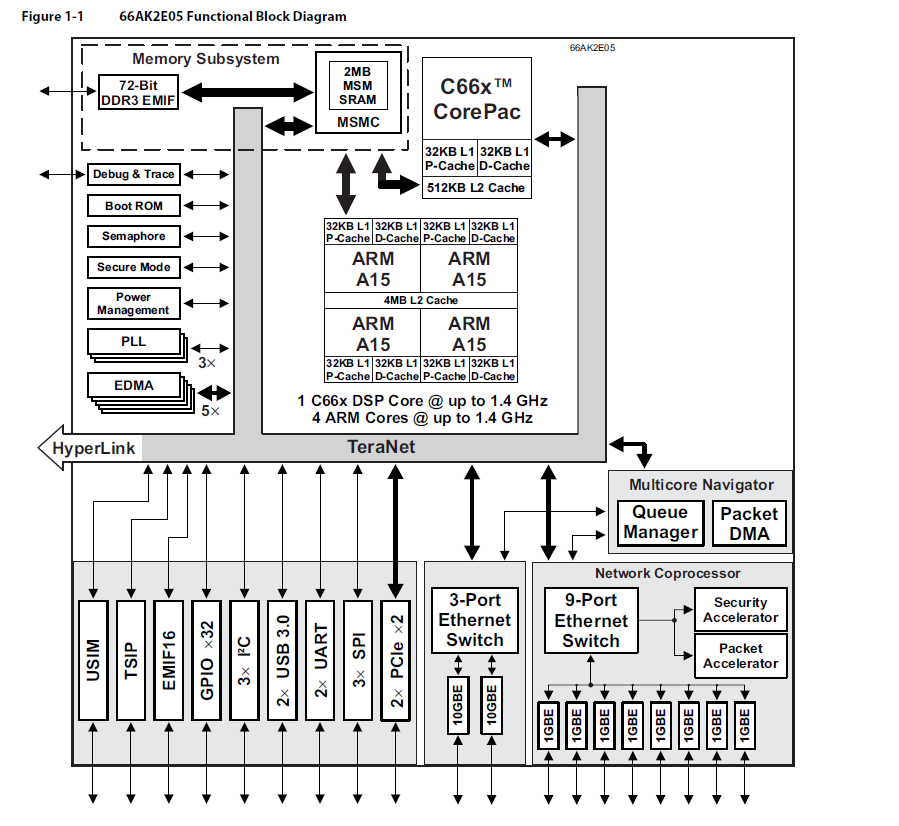

What DSP does the keystone 2 boards have?
This is block diagram of K2E board.
We have following peripherals.
K2E is quad core ARM cortexA15 and C66x DSP core.
PCIe,hyperlink, 4GB DDR3, 512MB NAND Flash, 128MB NOR Flash,On-board XDS200 emulator, On-board dual 10/100/1000 SGMII Ethernet, 1-port USB 3.0, USB mini and much more
Refer to the K2E data sheet to know better.
Please refer to the following links.
