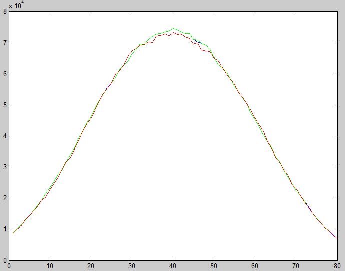

  • The result of a different issue, https://e2e.ti.com/support/development_tools/compiler/f/343/t/527232, lead me down a different path with this issue.
    Looking more deeply at the test failure, we were finding the peak of a correlation at a slightly different spot.  Plotting the correlation and comparing the C64p and C66 implementations showed only very small differences in the magnitude but enough at the peak to skew the result a few bins.  So, I dug even deeper.
    One thing that is causing a difference is the calculation of the twiddle factors seems to change from DSP V100 to C64p to C66.  Most notably the addition of the line
    d = floor(0.5 + d); // Explicit rounding to integer //
    to the d2s() function in the gen_twiddle functions for ifft and fft.  I removed that line and re-ran my tests.  My test passed, but I could see the magnitude response was not an exact match.
    Digging deeper into the values of the twiddle factors, I expected to see maybe the same values but in a different order.  Well, the DSP V100 twiddle factors seem to exactly match (order and value) with the C64p twiddle factors.  However, the C66 twiddle factors were further optimized and only 1/3 of the table is generated, so comparing the absolute values is very difficult.  I did confirm that every value that is in the C66 table has an exact match in the C64p table.  The C66 table has no negative values, so I am assuming that is handled in the ifft code somehow.
    So, while I can modify the C66 code and get my test to pass, that is certainly not desired.  I feel like the new C66 iFFT function it no bit exact match to the C64p or DSPLIB 100 versions.  The difference is very slight though.  Here is an example correlation showing the working (C64p) result in Green and the working but not quite right (C66) result in Red.

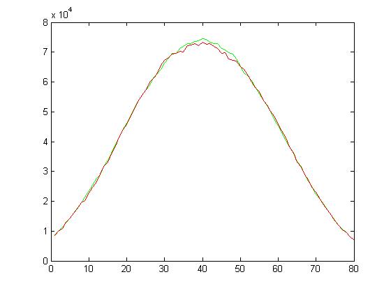

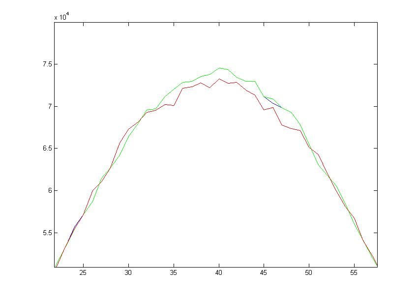

  • Here is another plot.  It shows in green the "working" C64p DSP_ifft16x16_imre implementation.  In blue, which is almost exactly covered by green is the C66 C Natural result and in red is C66 Intrinsic result.   I think this shows that this is not a result of the twiddle factors since they are the same for the red and blue results.  It does show the C66 Intrinsic and CN versions do not produce the same results.

  • What I try to say is that indeed the C66 may not be the bit exact results with C64p algorithm. The functional units of the C66 are different and there is no 40-bit accumulator. To get more than 32-bit one has to use pair of registers.
    I wonder which one is more accurate? If you take your input, convert it to double precision floating point and run the IFFT (you can use MatLab or Visual C or any other double precision support compiler, or even the C66) and compare the results with the results of the C64P and C66. Calculate the maximum error and some norm (like mean square) of the error in both cases (assume that the double precision is the golden standard)
    As you know fixed point calculations of large FFT suffers from truncation errors. You can try to use floating point (single precision) to compare to the golden standard. Convert you 16-bit input to floating point, calculate IFFT and compare the results and the performances
