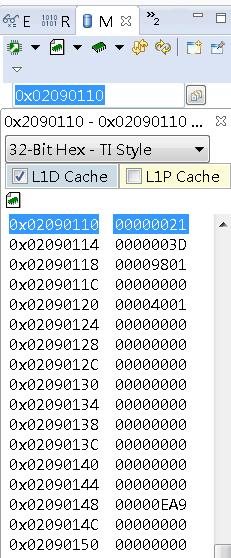

    Can you please read the LINK & MR_ADV_ABILITY registers and make sure that LINK is up properly.

    The MR_ADV_ABILITY reg is read as the figure below
    I set the 66AK2H14's MR_ADV_ABILITY 0x9801 but the MR_LP_ADV_ABILITY(BCM5389's) is 0x4001.
    So is there something wrong?

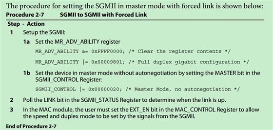

  • Feng,
    If the BCM switch port is configured as a MAC (SGMII Slave), then the K2H port must be configured as an SGMII Master.  This is not the standard configuration.  You will need to make modifications to the code to support this.  Please refer to Section 2.4.3 of the Gigabit Ethernet (GbE) Switch Subsystem User Guide (SPRUGV9) on the product page for 66AK2H14 for explanation.
    Tom

    I had configured the K2H's SGMII port0 as SGMII in Master mode with both auto-negotiation and forced-link as the following pics show.
    And the strange thing is that K2H had polled the SGMII_STATUS as link up, however the BCM5389's link up indication signal LEDA remains high to indicate no link up.
    So why?

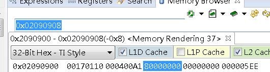

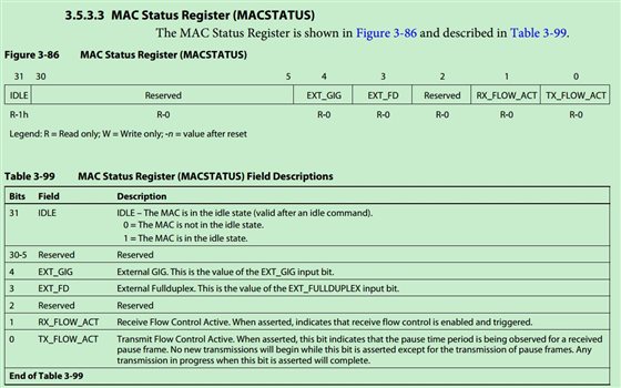

    I had checked the MAC Status Register, it shows as below
    Its value is 0x80000000. According to
    The MAC is in IDLE state. Is it normal??

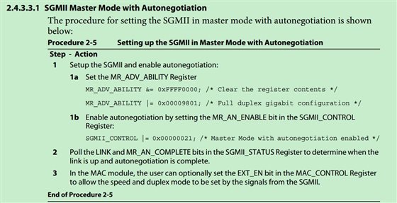

  • Feng,
    If BCM swicth port is MAC, then K2H14 SGMII has to be the master. You can use either master with AN or master with forced link as you tried earlier.
    In your latest code you used memcpy((void *)sgmiiCfg_Reg, &sgmiiCfg_Value, 4); Can you provide the register dump from 0x2090110 to 0x2090120 in both cases, I want to check the CONTROL, STATUS, MR_ADV_ABILITY, and LP_MR_ADV_ABILITY.
    Regarding MACSTATUS 0x2090908, it is 0x80000018 in our EVM where SGMII is the slave. So bit 31 is 1 looks OK.

    SGMII as master(0x9801 to MR_ADV_ABILITY) with AN:
    The registers you mention above are showed as below

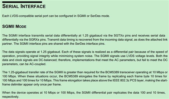

    I had some new findings.
    BCM5389's serial port has two mode: SGMII mode and SerDes mode.
    And it is SGMII mode as default. Should I change the mode to SerDes mode?? What's the difference?
    Feng
  • Feng,
    SGMII mode and SERDES mode both use the same baud rate and symbols.  As stated in your post, the negotiation is different.  The SERDES mode is for fixed data rate (1000Mbps) whereas the SGMII can negotiate lower data rates with a PHY.  The 66AK2H14 can also be programmed to forced mode to support the 1000BASE-X for fiber interfaces.  However, for your application, we recommend staying in SGMII mode and debugging the software.
    Tom

    	UInt32					sgmiiCfg_Value 	= 0x9801;
    	UInt32				   *sgmiiCfg_Reg	= (UInt32 *)0x02090118;
        CSL_SGMII_ADVABILITY    sgmiiCfg;
        CSL_SGMII_STATUS        sgmiiStatus;
    	/* Reset the port before configuring it */
    	CSL_SGMII_doSoftReset (macPortNum);
    	while (CSL_SGMII_getSoftResetStatus (macPortNum) != 0);
    	/* Hold the port in soft reset and set up
    	* the SGMII control register:
    	*      (1) Enable Master Mode (default)
    	*      (2) Enable Auto-negotiation
    	CSL_SGMII_startRxTxSoftReset (macPortNum);
    	//CSL_SGMII_disableMasterMode (macPortNum);
    	CSL_SGMII_enableMasterMode (macPortNum);
    	/* Setup the Advertised Ability register for this port:
    	*      (1) Enable Full duplex mode
    	*      (2) Enable Auto Negotiation
    //	sgmiiCfg.linkSpeed      =   CSL_SGMII_1000_MBPS;
    //	sgmiiCfg.duplexMode     =   CSL_SGMII_FULL_DUPLEX;
    //	//sgmiiCfg.bLinkUp		= 	1;
    //	CSL_SGMII_setAdvAbility (macPortNum, &sgmiiCfg);
    	//CSL_SGMII_disableAutoNegotiation (macPortNum);
    	CSL_SGMII_enableAutoNegotiation (macPortNum);
    	CSL_SGMII_endRxTxSoftReset (macPortNum);
    	/* Wait for SGMII Link */
    	if (!cpswSimTest)
    		do
    			CSL_SGMII_getStatus(macPortNum, &sgmiiStatus);
    		} while (sgmiiStatus.bIsLinkUp != 1);
    		/* Wait for SGMII Autonegotiation to complete without error */
    		do
    			if (sgmiiStatus.bIsAutoNegError != 0)
    				return -1;
    		} while (sgmiiStatus.bIsAutoNegComplete != 1);
    		 * May need to wait some more time for the external PHY to be ready to transmit packets reliabily.
    		 * It is possible to access the PHY status register through the MDIO interface to check when
    		 * the PHY is ready.
    		 * To avoid platform-dependent code, we just introduce about 2ms wait here
    		if((cpswLpbkMode == CPSW_LOOPBACK_EXTERNAL) || (cpswLpbkMode == CPSW_LOOPBACK_NONE))
    			CycleDelay(2000000);
        /* All done with configuration. Return Now. */
        return 0;
    Then I got the following results.
