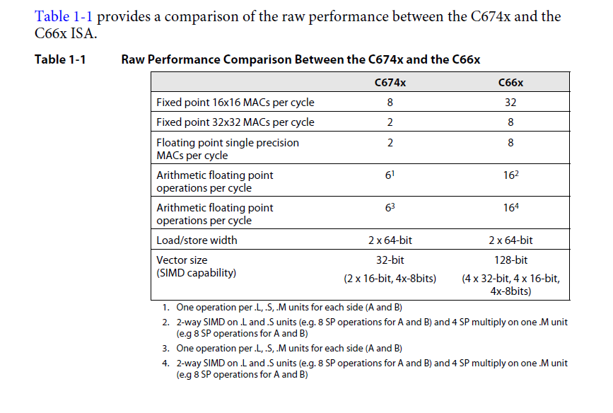

  • Hi Folks,
    We have a couple of additional questions for 2) as follows:
    According to the table in the URL below, The figure of the complex number FIR filter (DSPF_sp_fir_cplx) is (2/4*Nh*Nr + 40/4*Nr + 23).
    http://software-dl.ti.com/sdoemb/sdoemb_public_sw/dsplib/latest/exports/DSPLIB_C66x_TestReport.html
    We have additional questions about the figure.
    [Qustions]
    Let us confirm about the complex number FIR function.
    We believe that this means that if complex multiply-accumulate function is optimized by Pipelines + SIMD in C66x, a multiple-accumulate takes 2/4 cycles.
    In other words, two multiple-accumulate could be done by one cycle.
    Multiplication of complex numbers needs 4 MPYs and C66x has 8 32bit float multipliers.
    Therefore, if the data is stored in the registers, two multiple-accumulate can be done at one cycle.
    However, FIR filter does not handle the fixed numbers, so 2 complex numbers must be loaded from L1D cache ( if it is hit) to the registers.
    The bit width is “Load/Store width 2 x 64 bit “ ( = 128 bit ) which is shown on table 1-1 in page 30 in sprugh7.pdf
    www.ti.com/lit/sprugh7
    The 32bit complex float number is 64 bit width.
    It would be 128 bit when two numbers which are multiplied.
    With this reason, it seems the data for only 1 multiple-accumulate can be loaded at one cycle.
    C66x has pipelines, however, it seems impossible to load the data at background
    Moreover, it is 256 bit width between internal memory, but it is between L1 and L2 transfer.
    The clock speed is slower than CPU clock.
    If it is assumed that coefficient of FIR is fit into the register which means small TAP numbers, it would be able to load 2 data for a multiple-accumulate at one cycle
    Is this a kind of figure?
    Of is DSPF_sp_fir_cplx “Fixed Point 16bit” ?
    When two complex float values which are multiple-accumulated are read from L1D every time, is it rate-limited?
    In addition, it outputs finally onto L1D with FIR calculation.
    If complex multiples are repeated again and again, it outputs onto L1D again and again.
    The load from L1D and the store to L1D are individually 2 x 64 bit width.
    If RD and WR to L1D occurs simultaneously, two accesses done by 1 clock if there is no bank conflict occurs.
    Are we correct?
    This is asked because we would like to make sure if the load is defined a rate-limited, the number of cycles must not be increased.
    Hitoshi
  • Hitoshi-san,
    The C6000 architecture has 8 functional units that can execute an instruction each cycle.  There are two data units than are each capable of loading up to 64-bits of data from memory every cycle. These 64-bits can be 16-bit fixed point (so up to 4 16-bit values per side) or 32-bit fixed point (so up to 2 values per side) or 32-bit floating point (again up to two values per side).
    The C66x has 2 multiply units and each multiply unit is capable of 16 16-bit multiplies or 4 32-bit multiplies.
    Below is a table from the C66x instruction set guide SPRUGH7 that shows the load and multiply capability in terms of data size of the C66x.
    As you noted the load limitation is 64-bits per side. So for 16-bit fixed point math, I can only bring in 4 new pieces of data per clock cycle per side. And for 32-bit single precision floating point or 32-bit fixed point I can only bring in 2 32-bit values per side. So for real multiplies where I need new data every cycle, I am limited to 2 multiplies and adds but for complex multiplies where the data can be reused, we can increase the number of multiplies done.
    There also 4 other functional units that can be used for adds, logic expressions, compares or shifts. And these functional units can execute an instruction every cycle.
    So with these 8 functional units you can load data, multiply and add data every cycle. Where the pipeline comes in is you are not multiplying and adding the data that was loaded from memory this clock cycle. When loading from memory there is a four cycle latency before the data is ready in the register. So you are actually multiplying the data that was read four cycles ago. Similarly when you are doing an add, you are not adding the value to the multiply you did this clock cycle you are actually adding the data from the multiply of the a previous cycle (different data types have different latencies for the multiply to complete; table 5-2 in SPRUGH7 is a good place to start).
    Another question you had was on DSPF_sp_fir_cplx. That is a floating point function in DSPLIB. There are fixed point and floating point implementations of most common DSP functions (FIR, FFT, IIR, etc). When you see sp it means single precision floating point.
    I hope this answers your question on how it is possible to load data, do a multiply and add all in one cycle.
