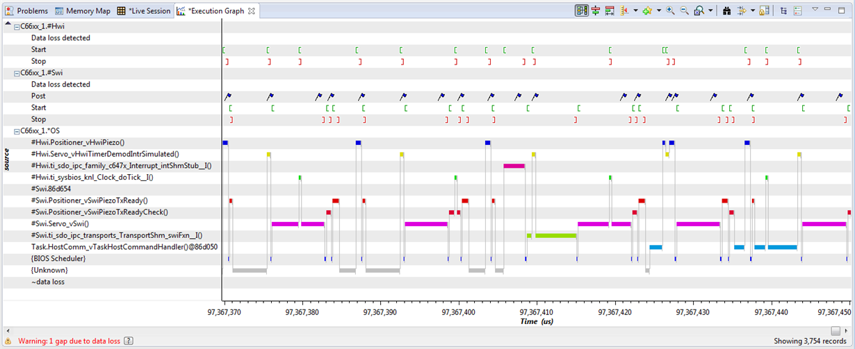

I am running SYS/BIOS (6.46.4.53) on cores 0 and 1, and am using IPC (3.44.1.01) to communicate between these two cores. I am using compiler TI v8.1.3 and XDCtools 3.32.1.22_core.
It appears that the SWI for IPC is running at the maximum SWI priority (15), because one of my other SWIs, Swi.Servo_vSwi(), is also at priority 15, and apparently cannot preempt the IPC SWI (see Execution Analysis screen shot, below).  This is causing significant "jitter" on my high-priority Swi.Servo_vSwi(), which my application cannot tolerate.  So I assume that I need to lower the priority of the IPC SWI.
Any suggestions?

  • Eric,
    Have you tried to lower the TransportShm_swiFxn task by updating the TransportShm_Instance_init() in packages/ti/sdo/ipc/transports/TransportShm.c? e.g.
       Swi_Params_init(&swiParams);
       swiParams.arg0 = (UArg)obj;
        swiParams.priority = 14;
       Swi_construct(Swi_struct(swiHandle),
                    (Swi_FuncPtr)TransportShm_swiFxn,
                    &swiParams, eb);
    Regards, Garrett

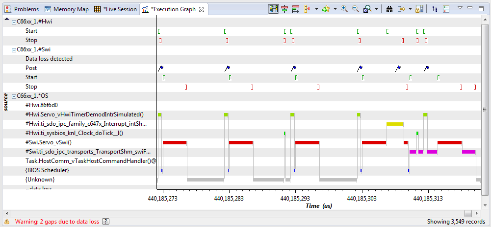

  • I have now successfully modified the priority of the IPC SWI (thank you Garrett Ding), and have successfully rebuilt my IPC library (thank you Sahin Okur).
    Lessons Learned (Windows):
       1) Do NOT have any MinGW / msys functions in the path,
       2) always use the gmake.exe that comes with XDCTOOLS to build the libraries
    Thank you again, Garrett and Sahin!
    Finally, I would STILL really like to have an XDC configuration variable to control this, so that I don't have to build and maintain a custom IPC library.
