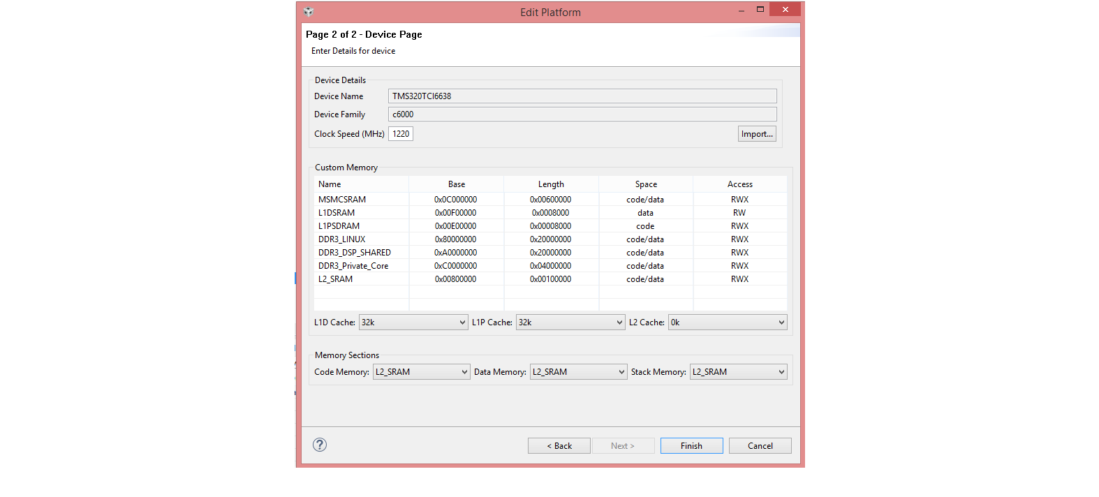

Hello everyone.
I'm new to EVMK2H boards. I have some questions about my problem and I hope that somebody helps me!
My main problem is about memory configuration. I wrote a simple code that creates a heap in external memory(DDR3A=2GB) and allocates some memory and it worked in CCS very well (Memory allocation is the last section of my main code), But when I try to load it via mpmcl from linux it gave me -104 error. After I read the below link, I recognize that it needs to change the device tree and MPMconfig.json file in the SDK directory.
I did the same as the link proposed but it did not work in my case! I change the device tree so that the DSP code place in the logical address 0xa0000000 with length 0x40000000 (physical address 0x820000000) and send CMEM to the address 0x860000000. I also changed MPMconfig.json as the attached file and added these lines of codes to my .cfg file so that create a heap. Is my way wrong to change the device tree? and why the linux gave this error in its log?
part of cfg:
var myHeapParams = new HeapMem.Params;
myHeapParams.sectionName = ".bootHeap";
myHeapParams.size = 64;
Program.global.myHeap = HeapMem.create(myHeapParams);
//Memory.defaultHeapInstance = Program.global.myHeap;
Program.sectMap[".bootHeap"] = new Program.SectionSpec();
Program.sectMap[".bootHeap"].loadSegment = "DDR3_DSP_SHARED";
linux error (tail -f /var/log/syslog) :
root@k2hk-evm:~# tail -f /var/log/syslog
Dec 23 18:59:48 k2hk-evm mpmsrv[547]: mpmsrv.c:110:mpm_server: received message of size 84 bytes for cmd 1
Dec 23 18:59:48 k2hk-evm mpmsrv[547]: mpmsrv.c:134:mpm_server: received load command for dsp0 filename /home/root/hello_GenericC66xxDevice.out
Dec 23 18:59:48 k2hk-evm mpmsrv[547]: mpmdlif.c:197:map_and_copy_segment: transport mmap failed for addr 0xa0000000 size 64 (err: No such file or directory)
Dec 23 18:59:48 k2hk-evm mpmsrv[547]: mpmdlif.c:1279:DLIF_allocate: map and copy failed for image /home/root/hello_GenericC66xxDevice.out with addr 0xa0000000, size 0x40
Dec 23 18:59:48 k2hk-evm mpmsrv[547]: mpmdlif.c:1442:DLIF_error: << D L O A D >> ERROR:
Dec 23 18:59:48 k2hk-evm mpmsrv[547]: mpmdlif.c:1445:DLIF_error: Failed to allocate target memory for static executable.
Dec 23 18:59:48 k2hk-evm mpmsrv[547]: mpmdlif.c:864:mpm_dlif_load: Image loading failed for file /home/root/hello_GenericC66xxDevice.out
Dec 23 18:59:48 k2hk-evm mpmsrv[547]: mpmssm.c:510:mpm_load_slave: Image loading failed for dsp0 : image
Dec 23 18:59:48 k2hk-evm mpmsrv[547]: mpmssm.c:419:mpm_ssm_state_error: entered error state for dsp0
Dec 23 18:59:48 k2hk-evm mpmsrv[547]: mpmsrv.c:77:mpm_server: waiting for slave message
device tree:

    I did another test which was changing the Data memory in my platform to the DDR_dsp_shared section and it worked again, but when I changed the code memory to DDR_dsp_shared, it gave -108 error about no entry point like the below link.
    e2e.ti.com/.../1072976
    please give me your opinion about my works! I think my change in the device tree is not enough and I did not take the correct answer!
