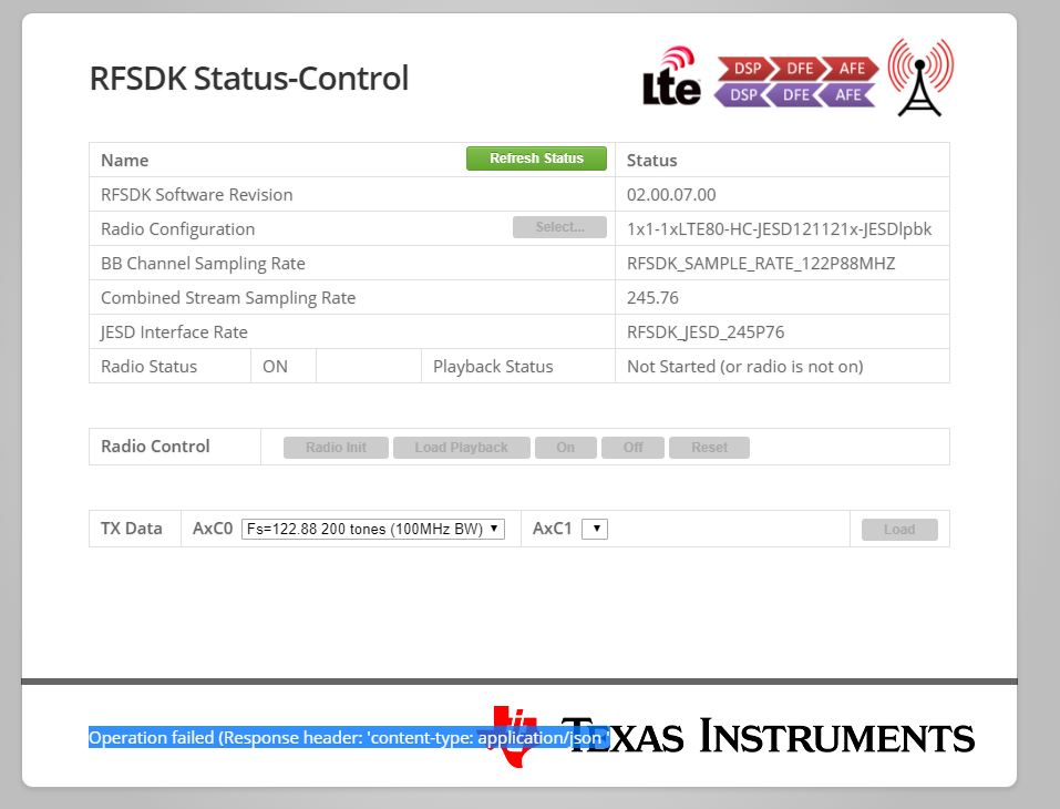

I am using MCSDK314 & RFSDK 02.00.07
why i can't  run web interface properly?
I can do it with command line (serial port)
radio reset
radio select 1x1-1xLTE80-HC-JESD121121x-JESDlpbk
radio init
playback program
playback start
radio on 18300 300
But when i try to do it with WEB interface, errors occurs.

    I sent you the JESD loopback example by using the console for the initial commands, and then using the RFSDK web page to look at results. The next step is to follow the user guide with the data converter and DLC cards, please look at E2E for the example no Tx configuration if you do not have a DAC38J84.
