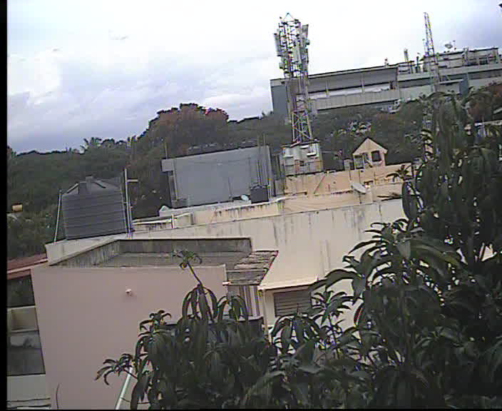

I am attempting to address the issue of video quality degrading over the process of de-interlace on the DM365 and the DM368. I see that the de-interlacer produces a rough gradient at the edges of any object in the video, which makes the video look artificial.
The following are the static configurations of the de-interlacer:
  • Input Format: UYVY422 (YUV422ILE)
  • Output Format: NV12 (YUV420SP)
  • Threshold: 0 [No improvement in quality observed when increased in steps to 100]
  • Frame Dimensions: 704x576
Since the DEI codec version is 1.x, it accepts one threshold as a static configuration. In addition to the DEI, the following are the versions of other components that are being used:
  • DVSDK 4_04_00_18
  • Framework Components 2.26.00.01
  • Codec Engine 2.26.02.11
  • Linux Utils 2.26.02.05 for Kernel v2.6.37
The following is a frame from the interlaced video:
The following is a frame from the de-interlaced video:
Over here, the roof of the building beside the telecom tower appears jagged - typical de-interlacing noise.
Would there be a configuration to decrease this noise? Besides, would an algorithm upgrade (to v2.0) improve this performance?

    I'd tinkered with both the motion threshold and the planar gap to empirically identify its impact on the quality. I found that the noise appeared different, although it was equally bad when quantified by gradients of intensity around certain noisy pixels.

  • Hi Prashanth,
    I have verified that the same instance produces both the fields in the input buffer. Besides, by dumping the content of the buffer directly into the secondary memory, I'm able to reconstruct the video independently, using FFMPEG on my workstation, with these fields. This tells me that the input video is the way it should be.

    In our use case, if simplified, the video handling pipeline goes as follows:
    Capture ----(UYVY422)---> De-Interlace ----(NV12)---> Resize ----(NV12)---> Encode / Compress (either H.264 or MJPEG)
    The images I have attached earlier are frames from video sampled at the beginning and at the end of the de-interlace. Regardless of the usage of the encode / compress process or its configurations, such as the bit rate for H.264 or the quality factor for MJPEG, these images are going to be as such.
    Naturally, encode / compress would cause subsequent quality loss, which would introduce noise that, theoretically, from the design of the encoding / compression algorithm, would not fit into this "staircase" pattern.
    These are the reasons for this problem being restricted to the de-interlacer. The encoder would not have anything to do with the occurrence of the quality loss between these two images.
    Based on Prashanth's inputs, it has been established that the portion of the application software that handles de-interlacing is robust - isolating the problem to the codec / middleware.
