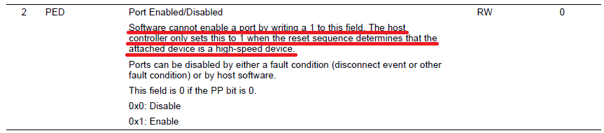

Hello.
I have a confirmation about operation of PORTSC_i->PED field.
There is description that PED field can not be enable a port by writing to this field in TRM. (sprugn4r: P3370)
My question is:
  - Can I enable this field manually by host? and how can I enable it?
   (some of usb transaction can enable it?)
Best regards, RY
  • Hi RY,
    As it is written in the TRM (sprugn4r: page 3370) the software cannot enable a port by writing a 1 to this field. The host controller only sets this to 1 when the reset sequence determines that the attached device is a high-speed device but the ports can be disabled by either a fault condition (disconnect event or other fault condition) or by host software.
    Therefore you cannot enable the PED field manually.

    But, my query is not cleared yet. May I have once more question?
    a) DM3730 USB controller needs external USB PHY.
    When PED field is enabled, USB controller actually reads PHY register to detect if high-speed device is attached.
    Is my considering right?
    b) Can you disclose the USB IP core vendor of DM3730 ?
    I would like to search more detail.
    Best regards, RY

  • Hi RY,
    Sorry for the delay. About your questions:
    a) Yes, low speed device is detected by its D- pull up initially and full/high speed is
    detected by pull up on D+. Hish speed device is distinguished from full speed device by the high speed
    chrisps on device reset.
    This is done by the PHY and read by the host via the ULPI.
    b) This information is confidential under NDA.
