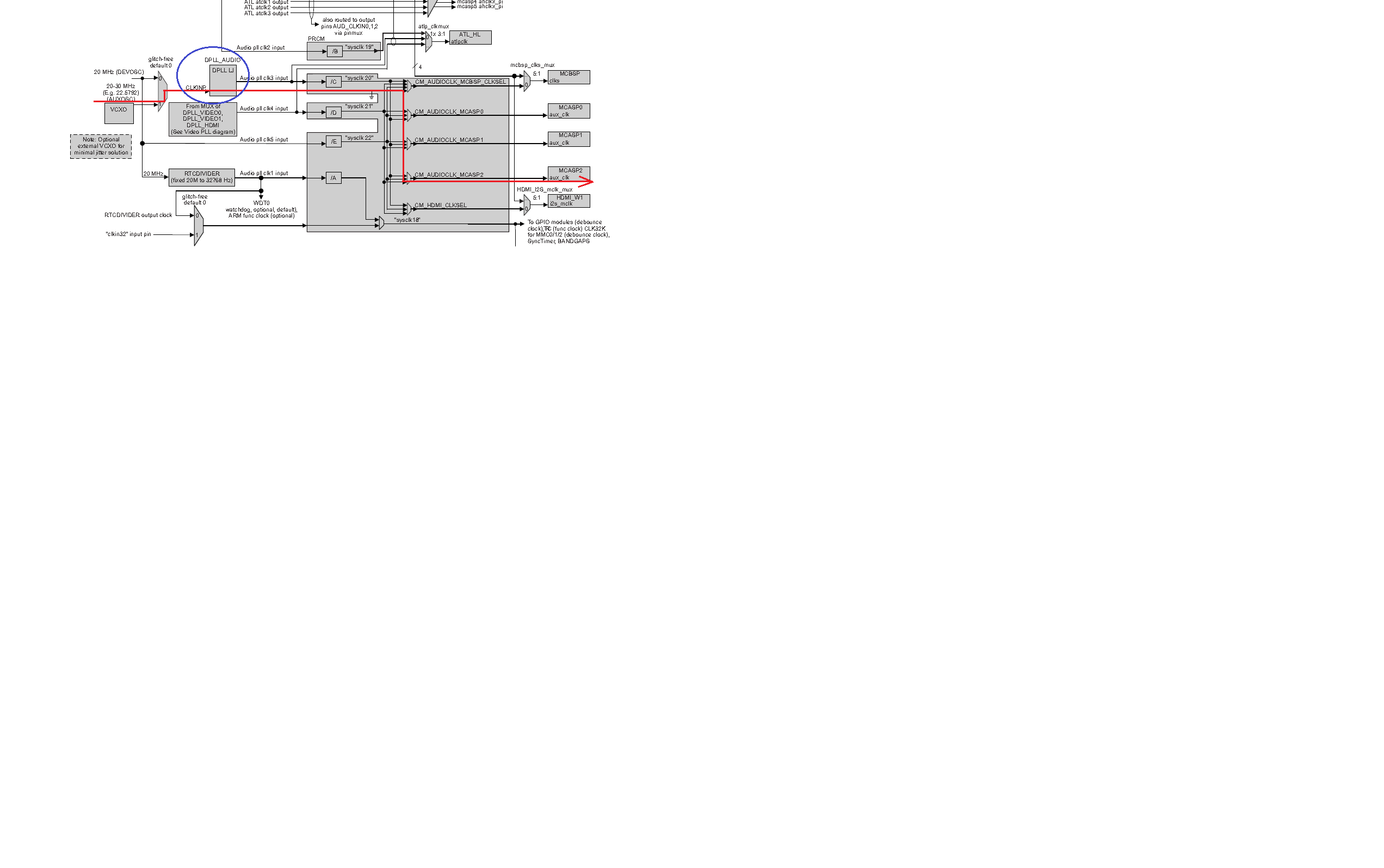

i want set AUXOSC_IN clock as audio osc clock. how to modify clock814x_data.c?

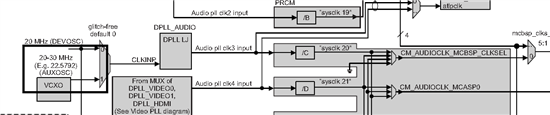

    Do you want to set the DPLL_AUDIO input clock (audio_dpll_clkin_ck) to be sourced from the AUXOSC clock input (osc1_clkin_ck)?
    Pavel
  • hi Lihou,
    In case this is what you want, one possible solution is to update the ti814x_clk_init(void) function as follows:
    int __init ti814x_clk_init(void)
    struct omap_clk *c;
    u32 cpu_clkflg = CK_TI814X;
       struct clk *clkp;
       struct clk *new_parent;
    clk_enable_init_clocks();
        clkp = clk_get(NULL,"audio_dpll_clkin_ck");
        if(!clkp) printk("audio_dpll_clkin_ck clk_get failed\n");
        else printk("audio_dpll_clkin_ck clk_get successed.\n");
        new_parent = clk_get(NULL,"osc1_clkin_ck");
        if(!new_parent) printk("osc1_clkin_ck clk_get failed\n");
        else printk("osc1_clkin_ck clk_get successed.\n");
       clk_set_parent(clkp, new_parent);
      return 0;
    Thus successfully change the parent clock from osc0_clkin_ck (DEVOSC) to osc1_clkin_ck (AUXOSC). Now reading bit OSC_SRC[24] AUDIO_PLL_SOURCE is 0x1 (AUXOSC), previously 0x0 (DEVOSC).

  • Hi Lihou,
    I have checked the Clock Framework. The audio MCLK that you are interested can be two clock signals:
    1. The clock input to the McASP2 module (aux_clk). This clock signal (aux_clk) is coming from the device PRCM.
    2. The clock output from the McASP2 module (ACLKX). This clock is input to the TLV320AIC3X audio codec.
    Could you please tell in which case your audio MCLK question is? I mean do you ask about the clock input to the McASP2 or to the clock output of the McASP2?

      yes, i want ACLKX output to the TLV320AIC3X audio codec. the frequency of the ACLKX signal is 24576000Hz.
  • Hi Lihou,
    Please read section 16.2.2.1 Transmit Clock, from the DM814x TRM. You will find there that ACLKX can be internally generated by programming bit ACLKXCTL[5] CLKXM = 1.
    Also all the way from the aux_clk to the ACLKX through the dividers is described also, you can adjust the frequency desired.

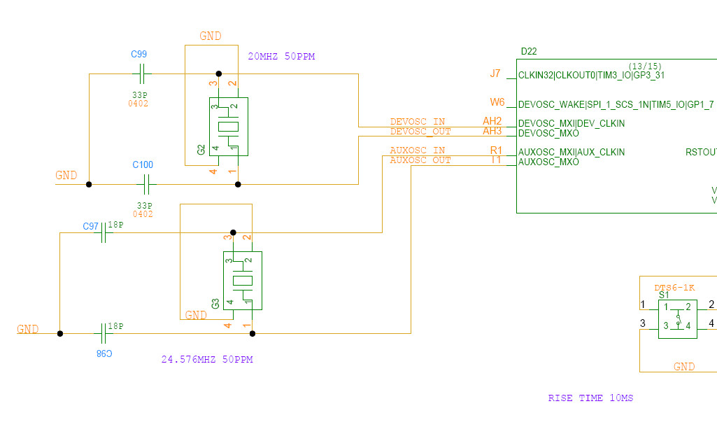

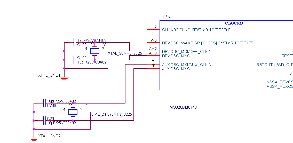

    I have added the code you gave me to the linux kernel,but the output of MaASP2 ACLKX is about 300MHz which is not I want .
    According to the electric schematic diagram,the clock source is from Y2.
  • Hi Pavel,
    I have added the code you gave me to the linux kernel.But the output of ACLKX is 300MHz.
    On our board ,the clock source is 24.576 from Y2.
    On EVM board , the clock source is 22.579 from Y6/Y7.

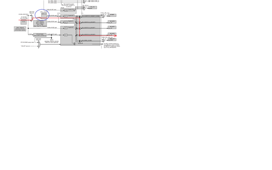

    I want to set McASP2 to get the clock from CPU.
    According to the TRM,I have select AUXSOC as the clock source.Please refer the red line in the below picture.
    The input clock (AUXSOC) is 24.576MHz, and I want the output clock(MCASP2 aux_clk) also is 24.575MHz.But the aux_clk is not right.
    So I think the problem is DPLL_AUDIO and Would you tell me how to set the DPLL_AUDIO registers to keep the clock all the same without changing.
    Thank you .
    BR
    Bob

  • Bob,
    From what I understand, you need to below clock path:
    AUXOSC -> DPLL_AUDIO -> sysclk20 -> McASP2 aux_clk
    And AUXOSC in DM814x EVM is 22579000 Hz, while in your custom board is 24576000 Hz.
    The first steps is to switch from DEVOSC (20MHz) to AUXOSC (22.579MHz on EVM, 24.576MHz on your custom board). From what I understand you know how to do this.
    The second step is to disable the DPLL_AUDIO, thus AUXOSC frequency will not be multiplied and stay the same. This can be done in u-boot:
    ti-ezsdk_dm814x-evm_5_05_02_00/board-support/u-boot-2010.06-psp04.04.00.01/board/ti/ti8148/evm.c
    void prcm_init(u32 in_ddr)
        /* Enable the control module */
        __raw_writel(0x2, CM_ALWON_CONTROL_CLKCTRL);
    #ifdef CONFIG_SETUP_PLL
        /* Setup the various plls */
        //audio_pll_config();   -----------> comment the audio pll config
        sata_pll_config();
    #if 0
        pcie_pll_config();
    #endif
    The third step is to switch from sysclk22 to sysclk20. We already discuss how this can be done.
    Finally you should end up with AUXOSC frequency provided to McASP2 aux_clk (mcasp3_fck in linux kernel).
    Pavel
