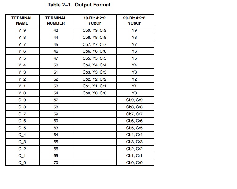

The output format of tvp5147 in data manual document:

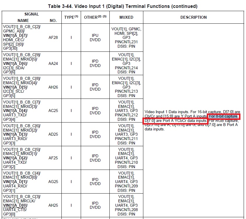

But in the file tms320dm8148.pdf,it says:
VideoInput 1Datainputs. For16-bitcapture. D[7:0]areCb/Crand D[15:8] areYPortAinputs. For8-bitcapture,D[7:0]arePortAYCbCrdatainputs. ForRGBcapture,D[23:16]areR,D[15:8]areG,andD[7:0]areBPortAdatainputs.

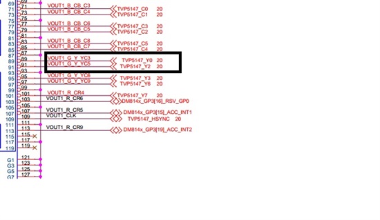

The terminals Y2~Y9 connect to D[15:8], C2~C9 connect to D[7:0].
I 16 bit capture,there is no question.But in 8 bit capture, tvp5147’s output is Y2~Y9 which connect with D[15:8],but dm8418 capture in D[7:0]. Am I right?
So, my question is can I use 8 bit embedded sync out format of tvp5147 on 8148EVM?
